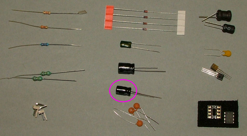

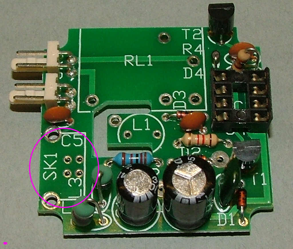

Next are the electrolytic capacitors. Fit the 470uF or 330uF smoothing capacitor into the C2 space, making sure the negative stripe faces the edge of the board:

Followed by the 100uF or 220uF 25V. This one stores the power used to switch the relay contacts and is marked C1, making sure the negative stripe faces the edge of the board:

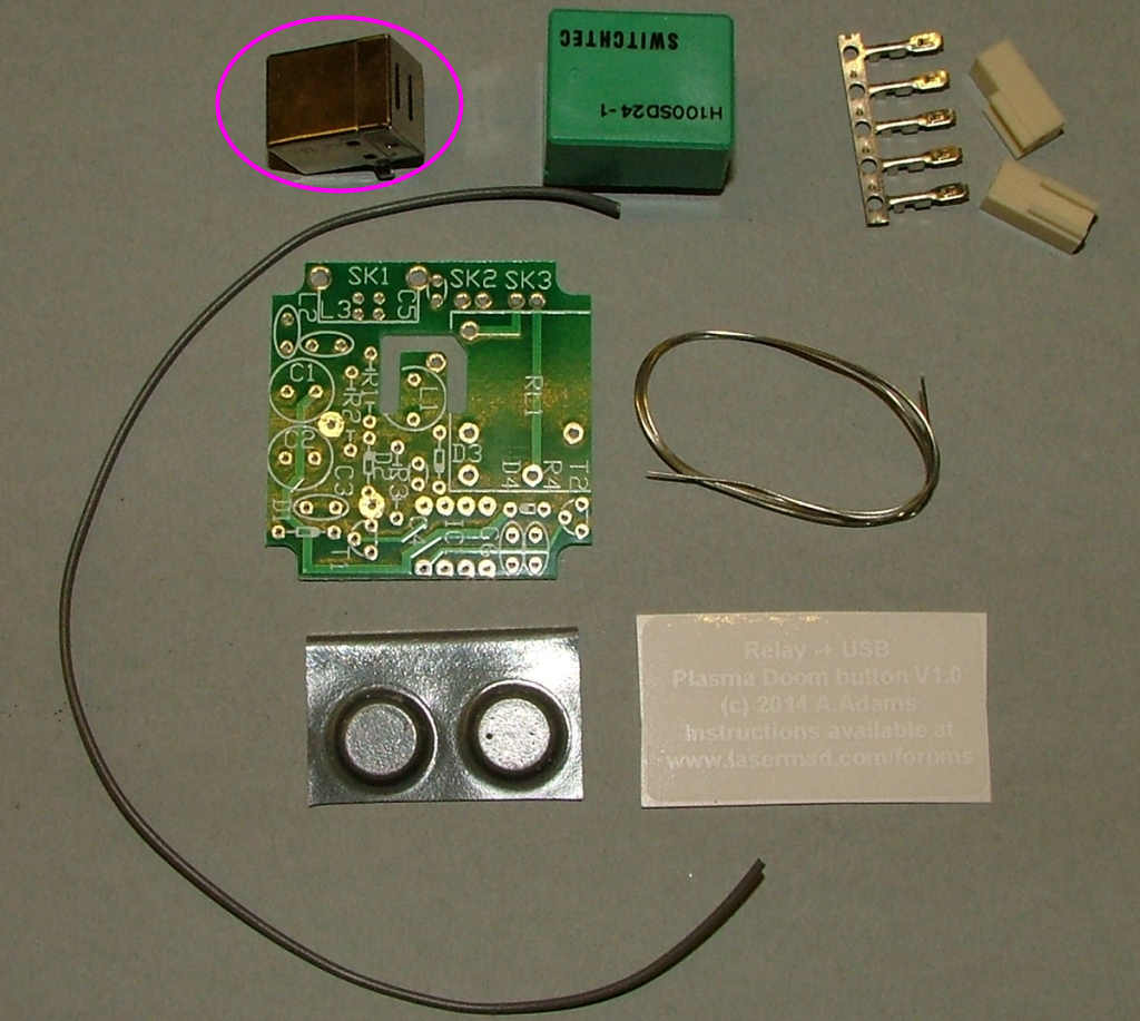

The last part for now is the USB socket, fit that in the SK1 holes:

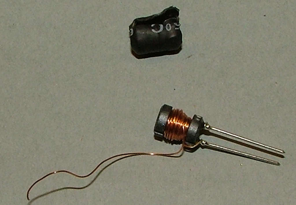

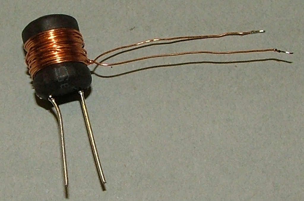

The next job is to make what will be used as the high voltage transformer - this is made from a 10mH inductor with a new primary winding added over the original coil. Take the 100uH coil (the smaller of the two radial inductors, if you have received two small inductors then it's the one with 2 short legs) and carefully remove the insulation covering it.
The only purpose of this part is to donate the wire to wind the primary.
Posts: 950
Post Sun Apr 19, 2015 5:33 pm
Re: PCB assembly
Carefully wind 27-28 turns around the larger coil - or the one with a long and a short leg if you received two small coils - as shown, leaving tails of about 1 1/2". Don't remove the insulation from that coil, just wind the wire over the top of it. You'll probably need all the wire from the first choke for this. Wind as evenly and neatly as possible and avoid leaving gaps or loose wire.
Tin the ends of these, the insulation should burn off using a soldering iron without needing to scrape it away.

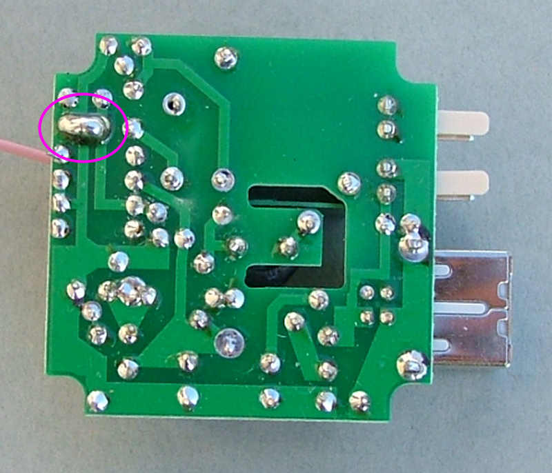

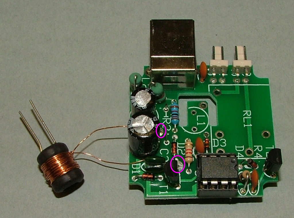

Solder the 2 tails to the pads shown, one between C1/C2 and the other next to T1:

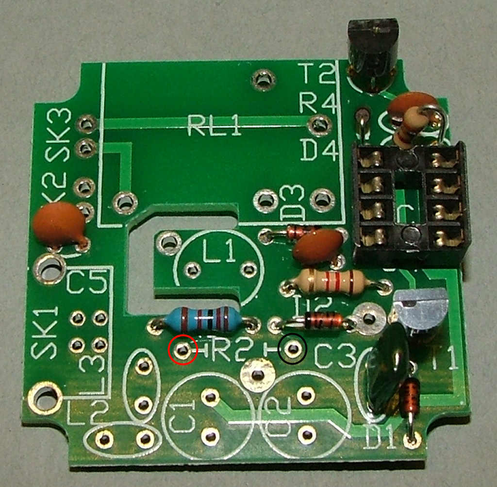

Almost time to power it up for the first time. Before that though, bridge the 2 pins of C6 or R4 to prevent damage to the PIC if anything goes wrong:

After making sure you have everything assembled correctly and the are no unwanted solder bridges fit IC1 into its' socket then connect a meter on a 200mA range to the pads of R2 (shown here on a partly assembled board for clarity):
Connect the USB lead to SK1 and the power supply. Make sure the L1 transformer isn't near the PCB, switch on and check you have a reading of 120-140mA. If it's a long way from this switch off and check everything again.

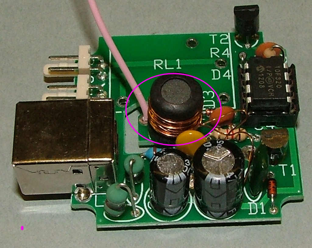

If the current reading is OK fit the coil assembly as shown. Strip and tin one end of the piece of insulated wire then connect the length of wire to the pad next to the transformer - this will connect to the nixie when the case is assembled.

Fit R2 (Yellow resin bead) across the pads you used for the mA meter - this is a resettable fuse:
