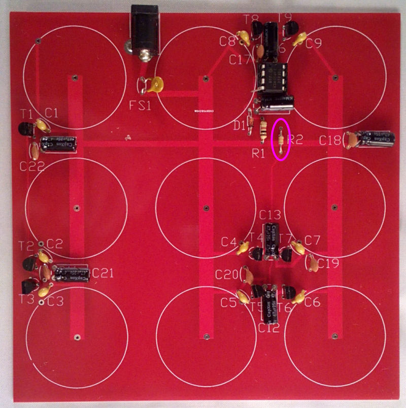

Next fit R2, 24k:

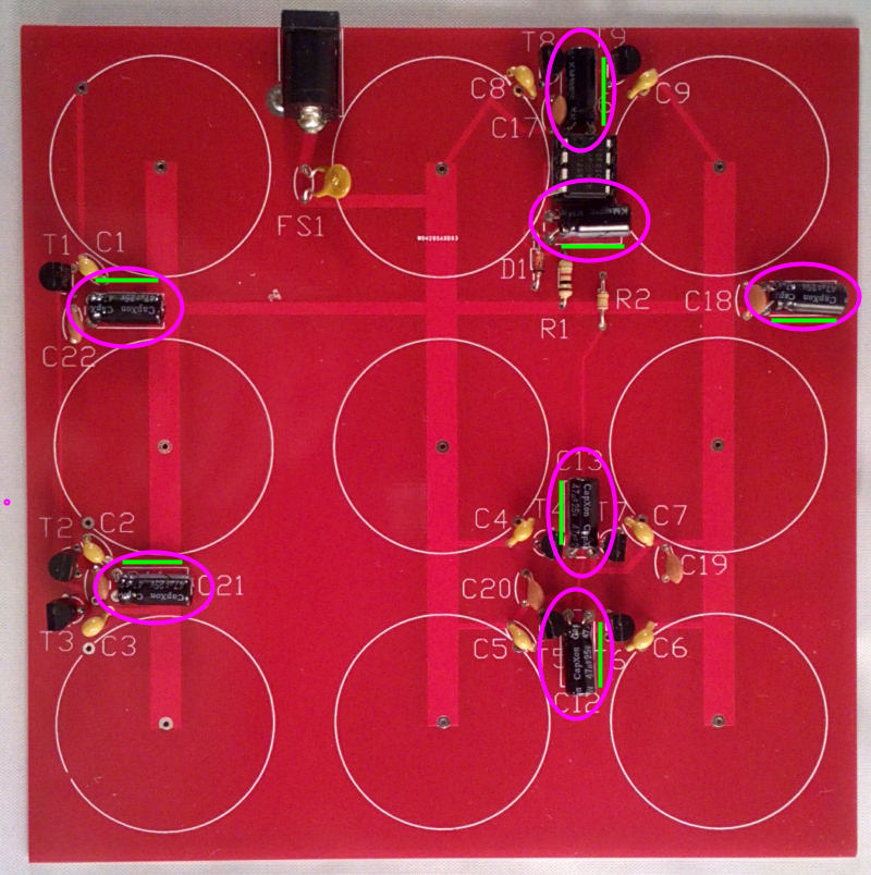

Next the 6 (or 7) electrolytic capacitors. If you have 6, leave out C15. Note that these are polarised and the negative band on the case must face the same way as the green lines in the picture.

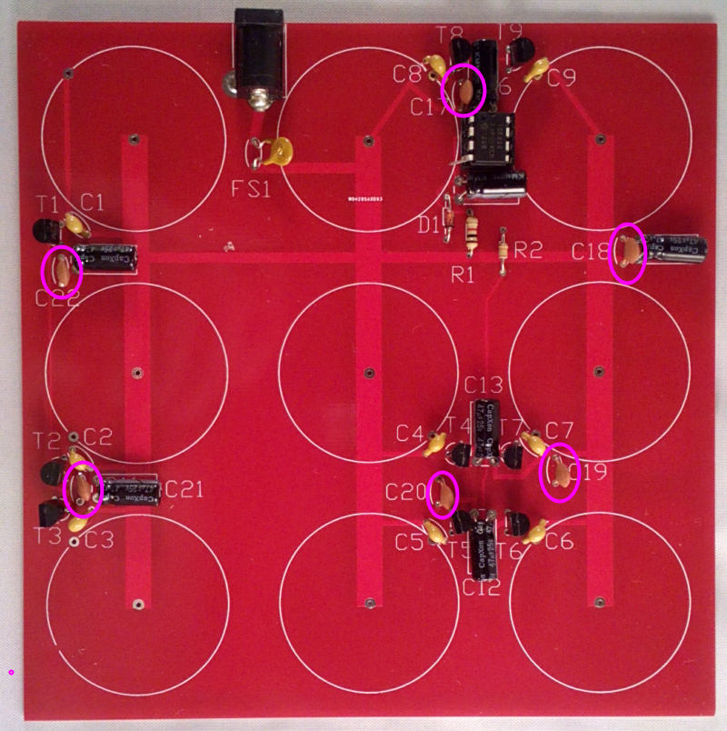

Last capacitors and almost time for the first test. Fit the 9x 1n (102) multilayer ceramics:

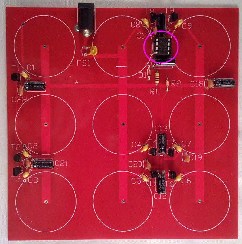

Now fit the 8-pin IC socket and then IC1. Bend pin 4 out to one side and make sure it's fitted with the notch marking pin1 facing up to the top edge of the board.
