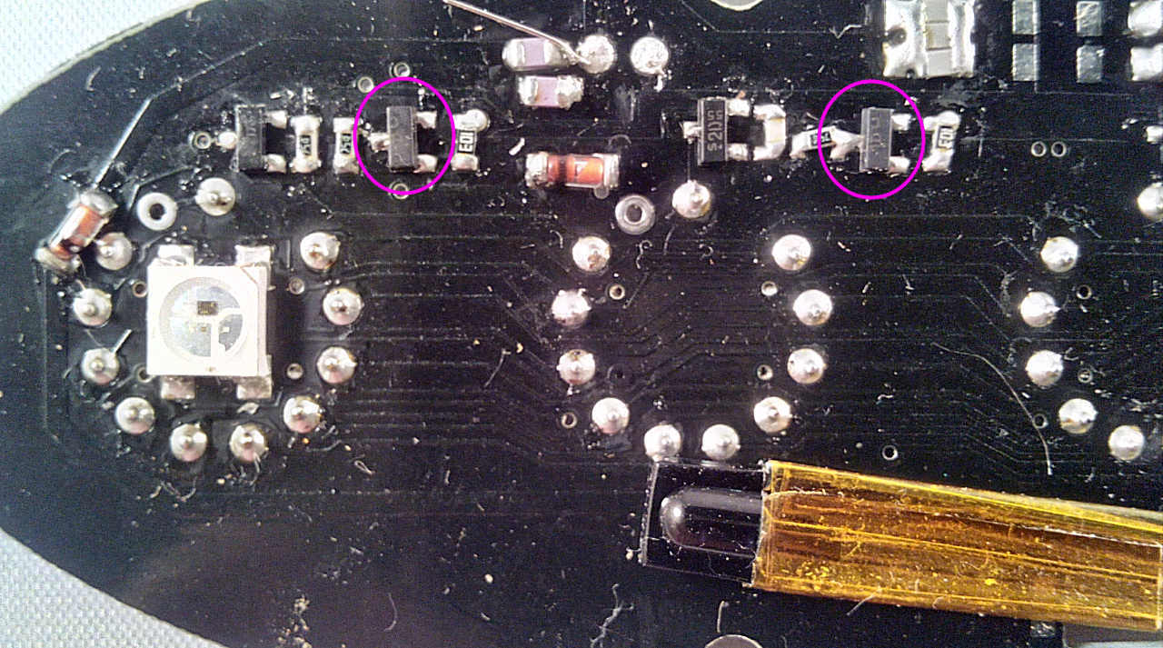

Start with the MMBTA92 transistors which provide the nixie anode switching. These will be marked '2D, on a black antistatic strip of 5 3-legged plastic squares':

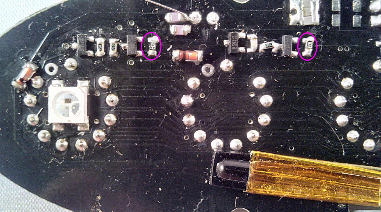

Next the MMBTA42 transistors which control the 92s. These will be marked '1D', a black antistatic strip of 5 3-legged plastic squares:

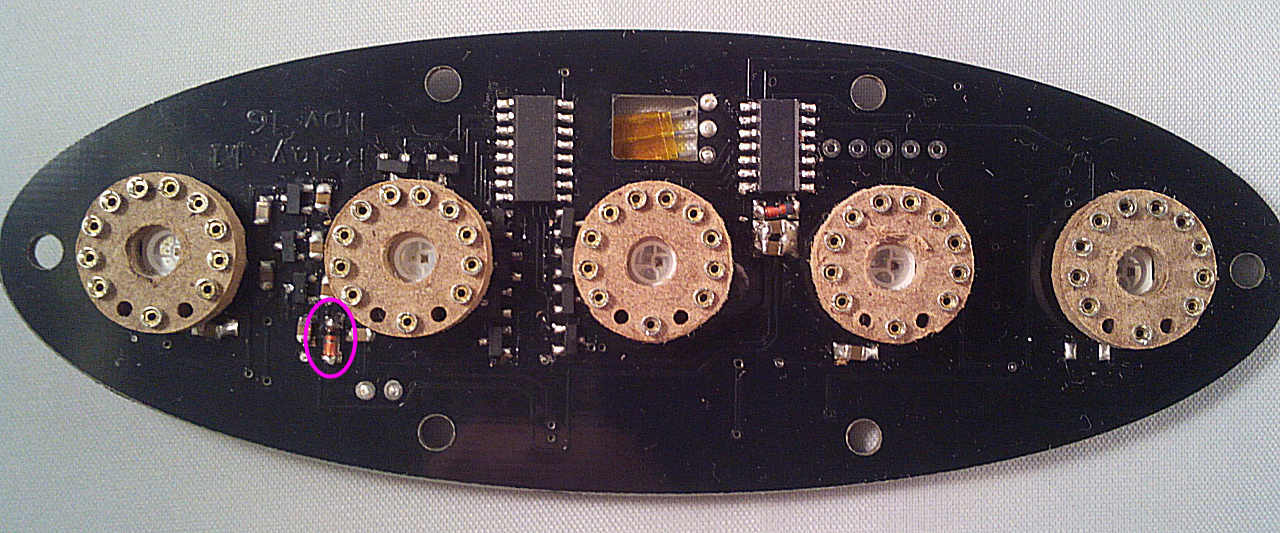

A large number of ll148 clamp and rectifier diodes next. These are copper coloured glass cylinders with metal ends on either a strip of 13-14 or 2 strip, one 10x and one 3x. They are the only diodes in the kit with a clear platic carrier strip. Make sure they're fitted with the black polarity band facing the same way as shown in the photographs:
You may want to leave the single diode on the other side for later:

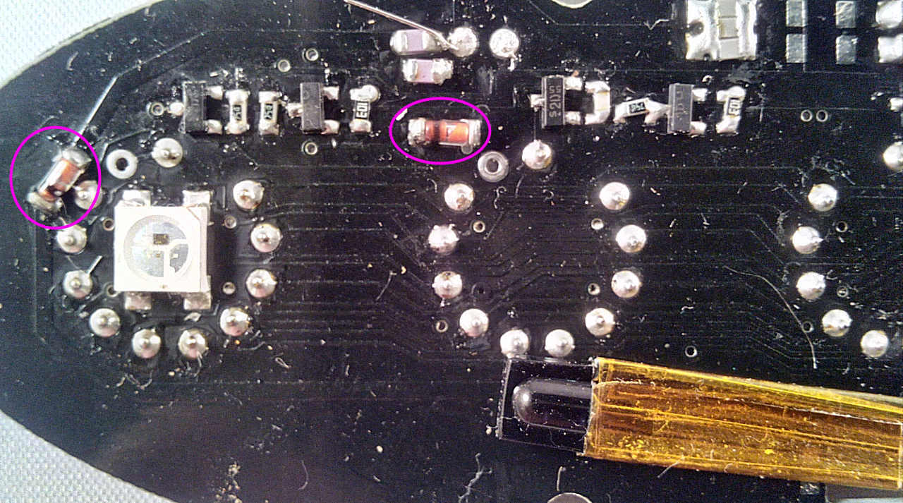

The 2x 75V zener doides now, these are copper coloured glass cylinders with metal ends on a black antistatic plastic strip of 2. Make sure they're fitted with the black polarity band facing the same way as shown in the photograph:

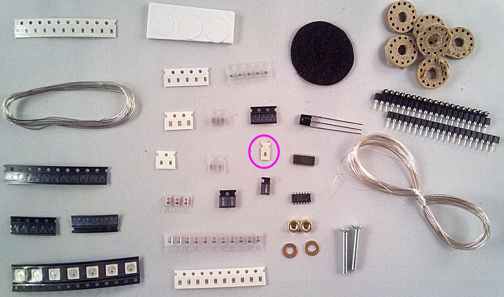

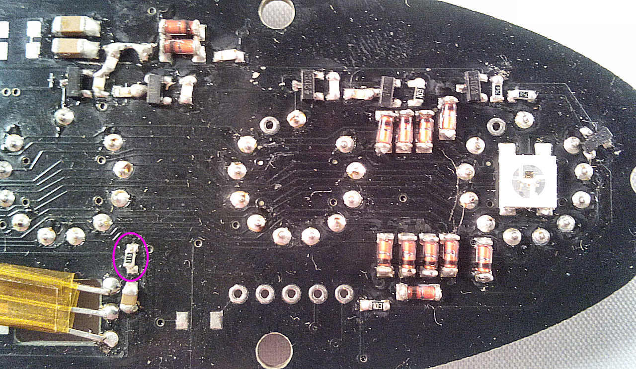

One small 91r resistor, this supplies 3.9v to the IR receiver. It's on a cream paper strip of one and marked '910' :
