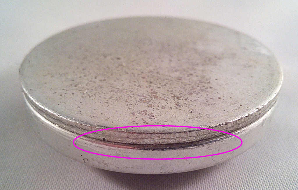

As supplied it has a steel weight stuck to the top, this will need to be removed before using it. The glue used is quite weak but the magnetic hold is strong, you'll need to force it apart at this groove - how you do it is up to you - I've removed many of them easily but I can't suggest how just in case it causes injury.
Do not heat it up to soften the glue, it doesn't need to be so just keep it at or close to room temperature as the Curie point for these super-strong magnets is quite low.

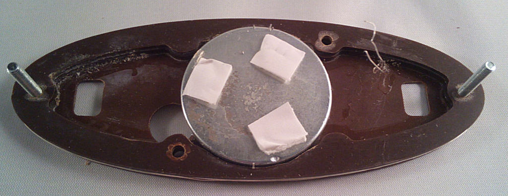

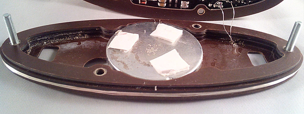

Push the magnet into the coil assembly as shown - you may need to sand or Dremel the edges of the hole slightly as there's very little clearance.:

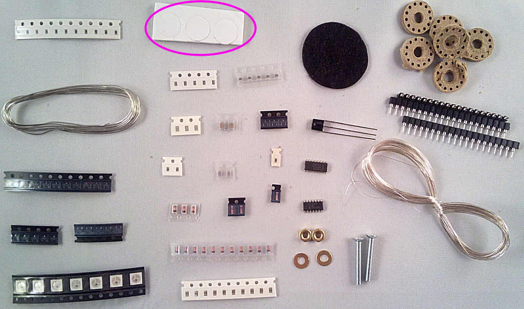

Stick the 3 double sided adhesive foam pads onto the magnet as shown above but leave the wax paper on the top side so they're not sticky:

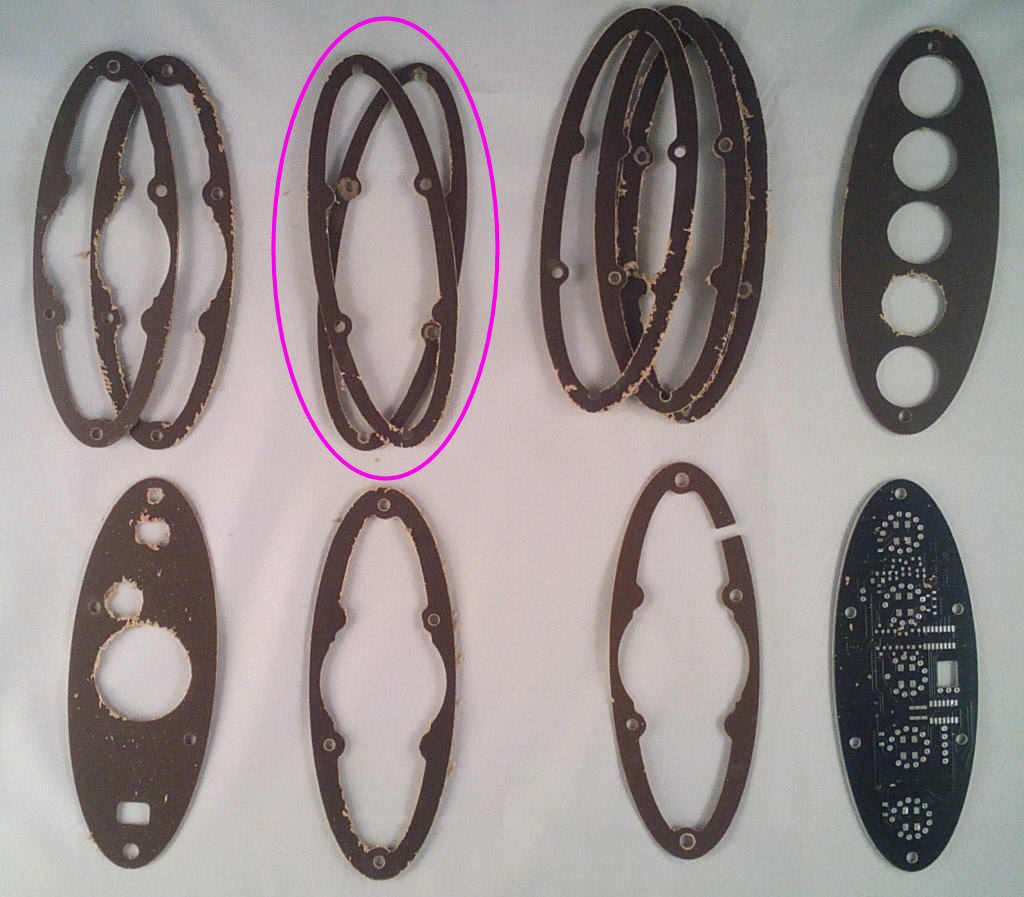

Now drop the second 'narrow, shaped' loop onto the coil assembly - you can now see they're shaped to fit around the magnet:

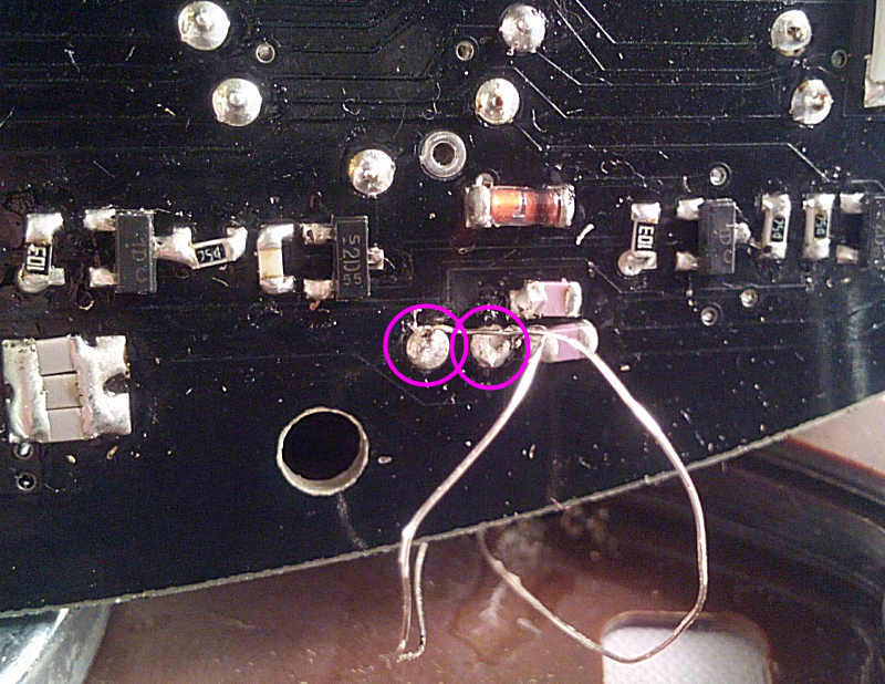

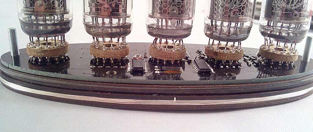

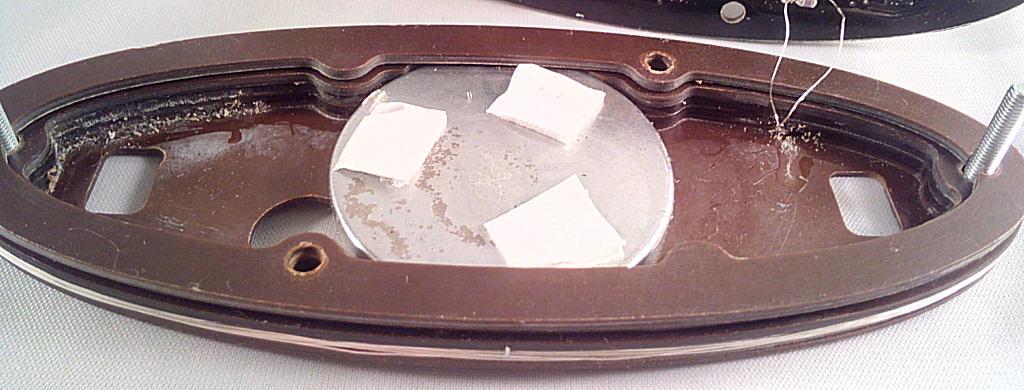

Solder the 2 coil wires to the clock PCB and drop it onto the stack, making sure the wires don't foul anything. There should be about 7mm of empty space for them under here:

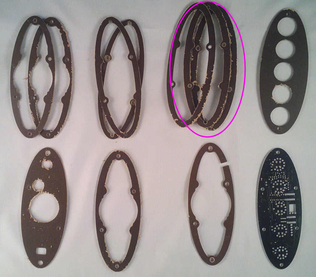

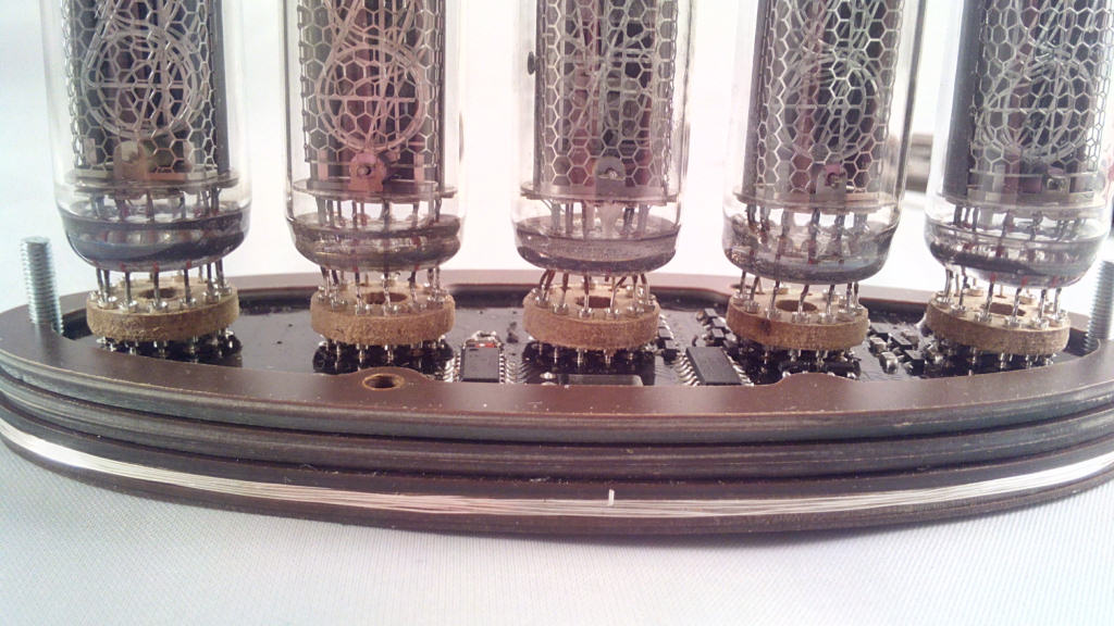

Followed by another 'wide plain' ring:
Posts: 937
Post Fri Dec 01, 2017 7:32 am
Re: Case Assembly
Followed by a 'narrow plain' ring:
Posts: 937
Post Fri Dec 01, 2017 7:33 am
Re: Case Assembly

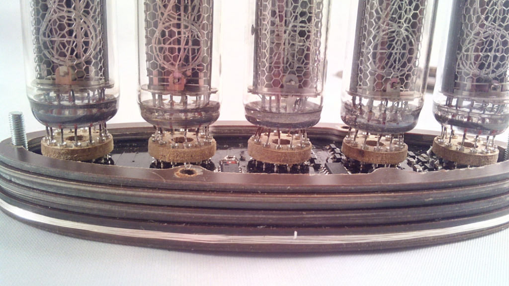

And the last 'wide plain' ring:
Followed by the last 'narrow plain' ring:
Should leave you with this:

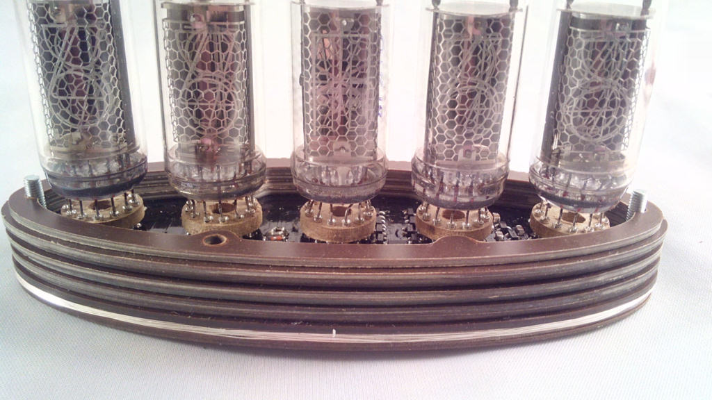

Finally the case lid:
Bolt this down using the 2x brass washers and M3 nuts to complete the Beacon module assembly.
