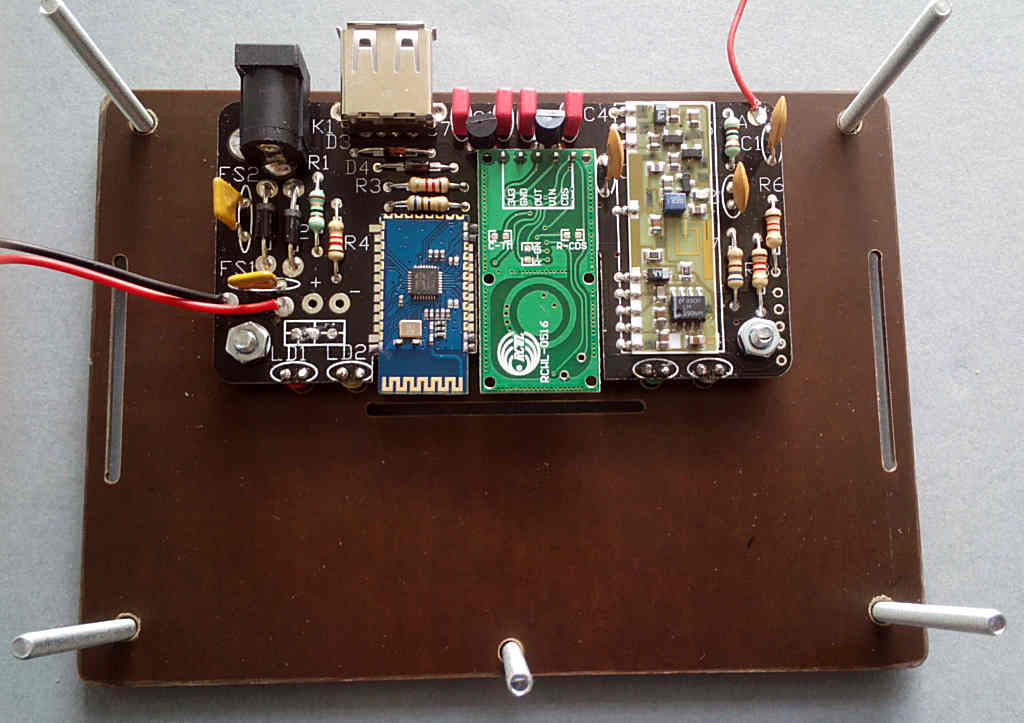

Start with the case front, push the 2x M3x12 bolts through the indicated holes, turn over and drop the nylon spacers onto them:
Fit the PCB onto them with the modules facing up, the LEDs will fit through the holes in the front panel. Put a plastic washer on each bolt to protect the PCB from the nuts, then fix down as shown:

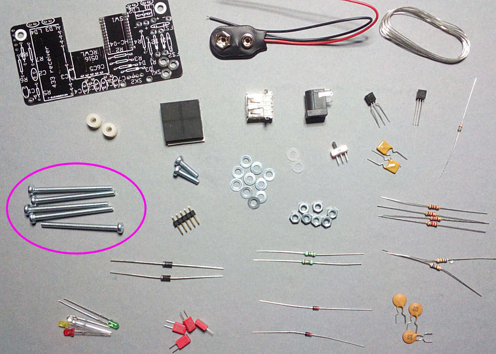

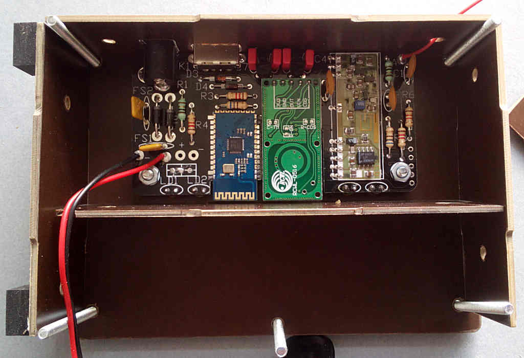

Put washers on 4 of the long M3 bolts and push them through the corner holes - leave the centre one for now:
Put the 4 tabbed side panels in as shown, feeding the antenna wire through the hole nearby:

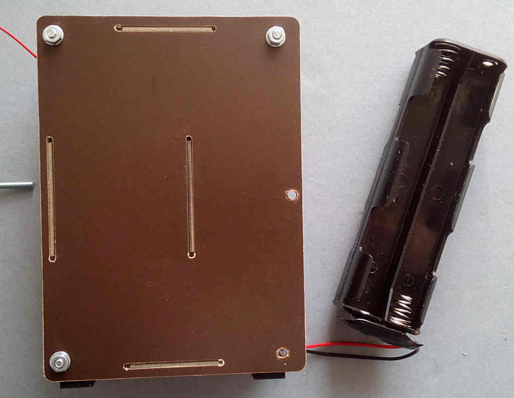

Then put the case back over them, making sure all the tabs fit into the slots in the back panel. Use a washer and nut in the 3 corners shown to hold it in place:

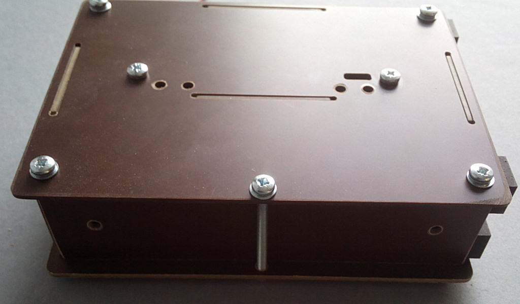

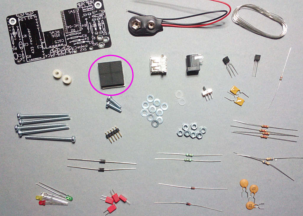

Clip the battery box onto the PP3 clip and push it into place - you won't be able to do this unless that bottom right bolt is removed. Once it's in, fit the 2 remaining bolts then slide the untabbed covering panel into place before tightening all the bolts. Put the 4 rubber feet on the bottom of the case - either the back panel or as shown in the picture as you prefer (experiment with what gives the best movement detection in your application).
