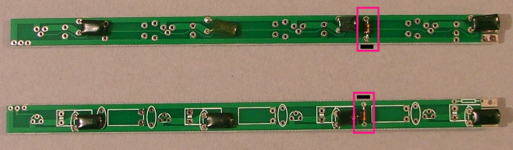

Next the 14V zener diodes (the strip of 14 glass beads), fit these as shown for each of the pair of PCBs. These are polarised and the black band must face as shown:
These aren't needed on all the PCBs as they're just for overvoltage and reverse polarity protection. Use 10-12 of the diodes provided.

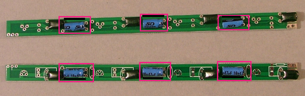

Now you need 3 of the black or blue 47u capacitors for each board, fit these as shown for each of the pair of PCBs. These are polarised and the black stripe must face the way shown:

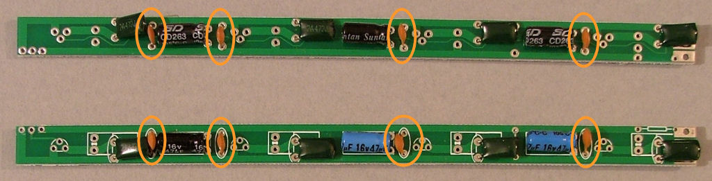

Next 4 of the brown 10n capacitors for each board, fit these as shown for each of the pair of PCBs. These are not polarised and can go either way around:

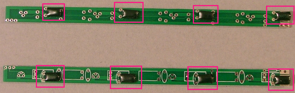

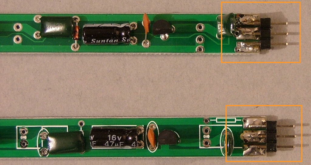

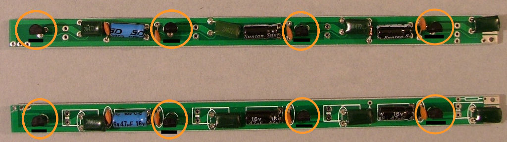

Next the driver transistors (the 3 legged black things) 4 fro each board, the is where it can get a bit tricky. Fit these as shown for each of the pair of PCBs with the flat side facing the black band on the photo. The tricky bit is the position of the centre lead - on the bottom board with the silkscreen marking on top it's under the curved edge of the transistor but on the 'mirror' board it's sticking out from the flat edge:
Re: Board PCBs
Now cut a block of 3 pins from one of the header pin strips. Push the plastic spacer to about the halfway position and solder it onto the end of the PCB as shown:

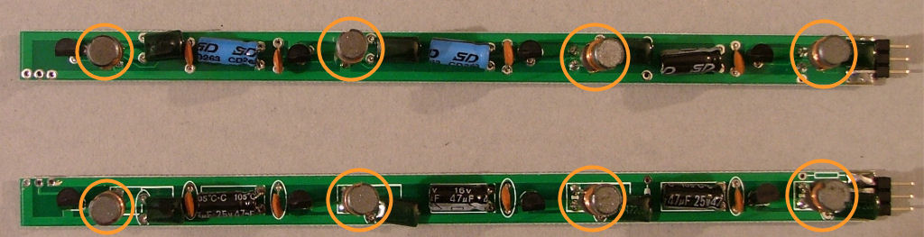

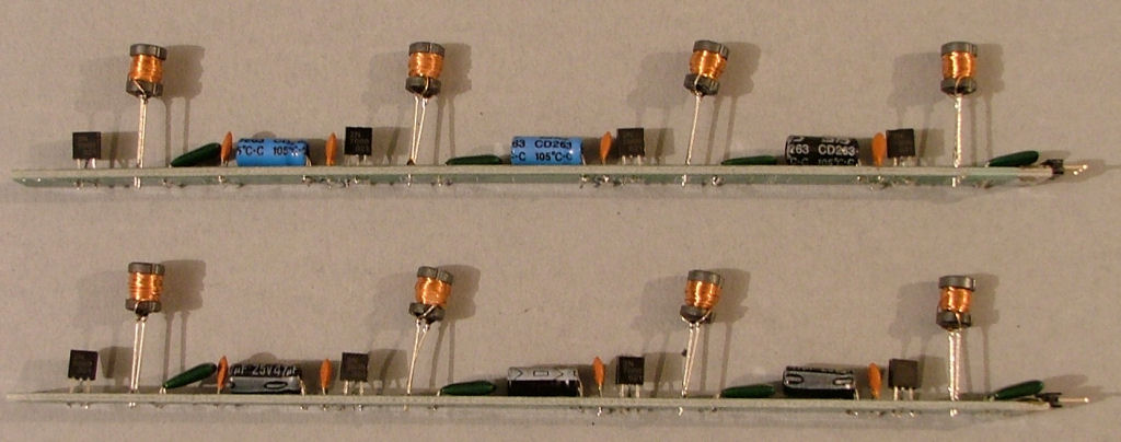

Finally the coils themselves, as supplied they have a protective heatshink sleeve which needs to be removed. I found carefully cutting it with flat edge wirecutters to be easiest but be careful not to cut the copper wire underneath or damage the brittle ferrite base.
Fit these as shown for each of the pair of PCBs. These are not polarised but just push the wires far enough into the board to be soldered, leaing them as long as possible for later adjustment:
You may want to pre-bend them so the coil is at 90 degrees to the leads or just leave them like this for now until final assembly.

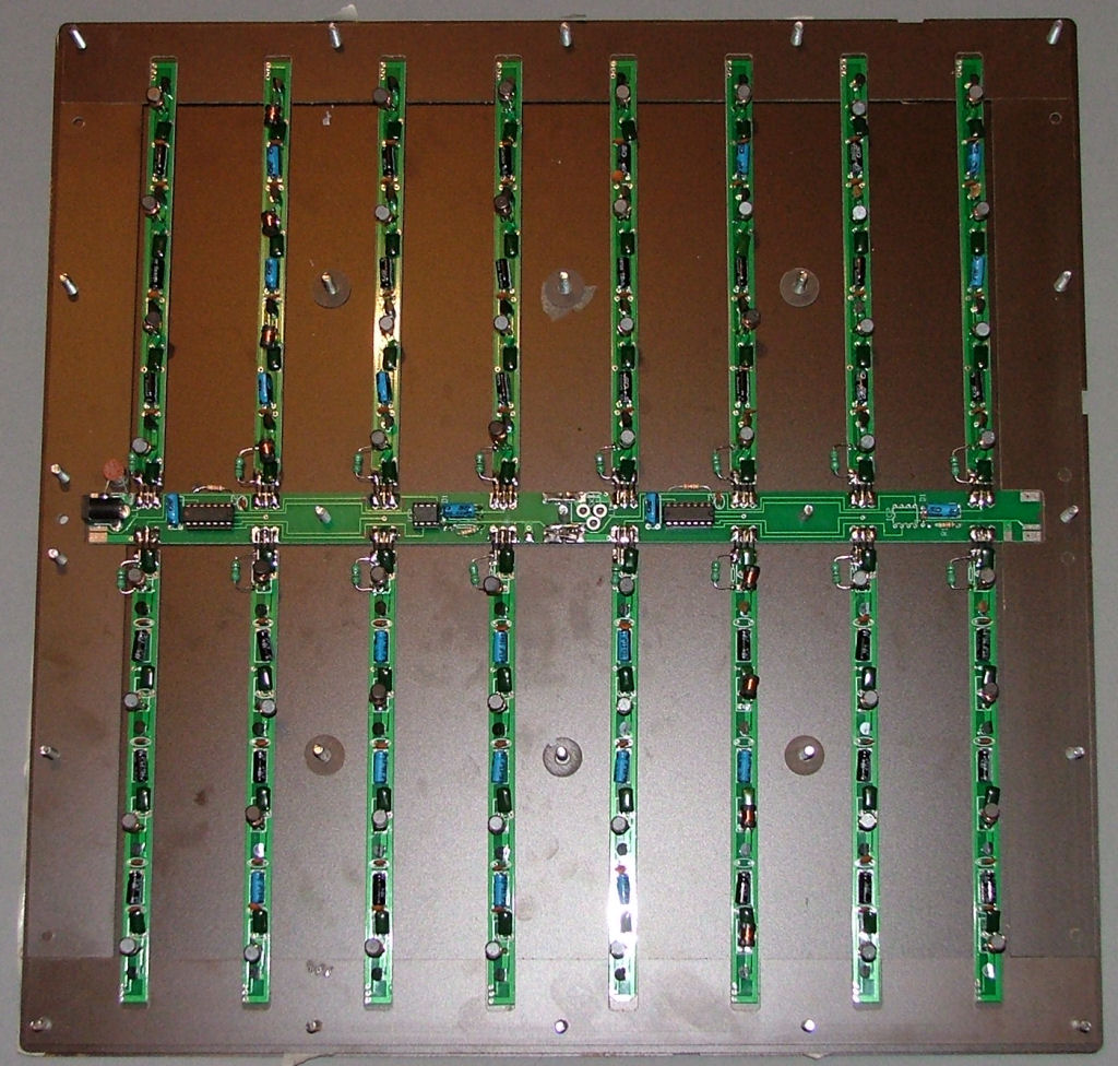

Assembling the complete PCB frame is easier using the board case as a guide. Build up the first 2 layers of the sides and assemble the spine and driver PCBs as shown. The coil PCBs with parts fitted on the top side are at the bottom of the case, the 'mirror' PCBs are at the top.
Centre the header pins on the spine PCB pads and solder in place for all 16 coil PCBs. They'll be tested one at a time as any faults at this stage could destory all the driver transistors that are powered.
With your multimeter on a low ohms range check between the 3 pins on each coil PCB to make sure there aren't any shorts. Reconnect the meter on a low mA range again across F1 and repeat the power up test, the current should still be less than 30mA.
Check the voltages again at the centre pin of each coil driver PCB, it should be about the same as your last test a few posts back. Any missing voltage here will probably be a solder bridge under a transistor.
