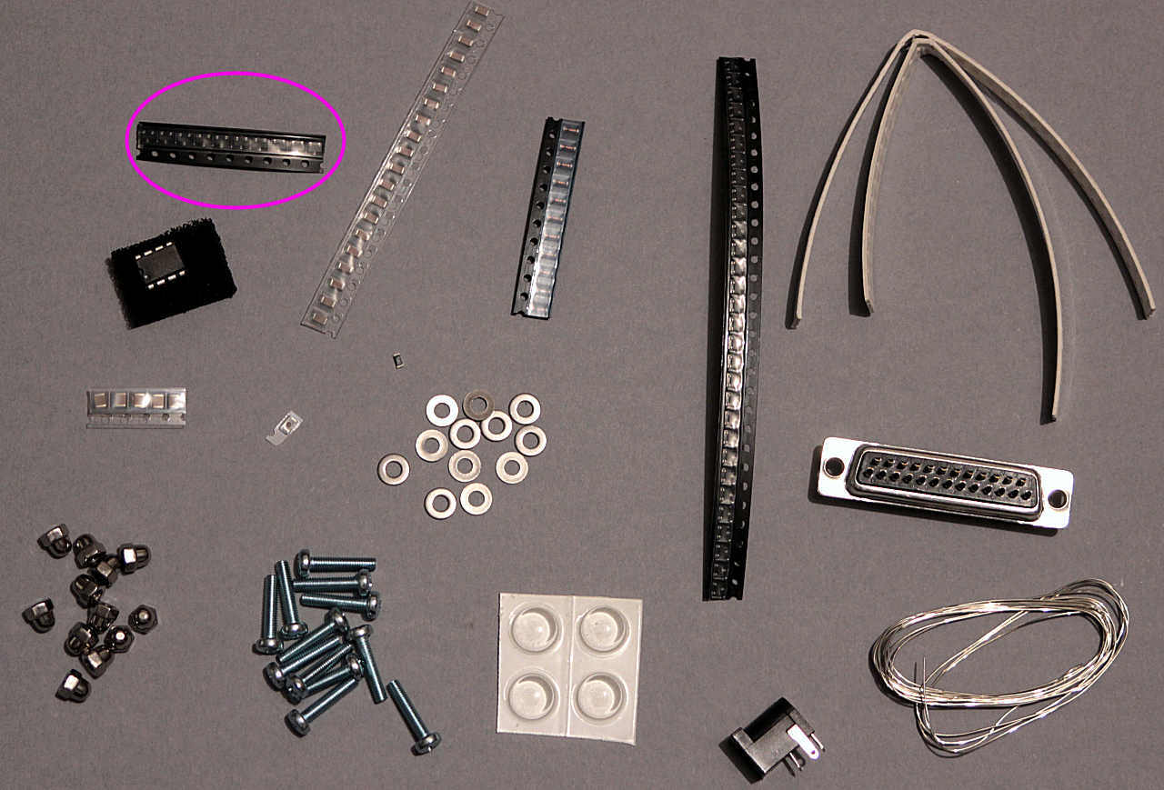

Unpack the component bag and sort them out into separate piles. You should have:
9x 2n7002 transistors (3 legged rectangles) These must be fitted the right way round.
18x 1n ceramic capacitors (grey ceramic)
9x BAV99 diodes (glass beads)
27x BAV103 diodes (3 legged rectangles, don't mix them up with the transistors) These must be fitted the right way round.
70x 100n capacitors (brown ceramic)
5x 10u capacitors (large brown ceramic)
1x 100R resistor (black rectangle with printed white number) - not in the latest batch.
1x 25 way D socket, for tube pins
12x M3x16 bolts, M3 washers and M3 dome nuts for case assembly.
4x rubber feet
5g solder
1x 3.1mm socket
Only some of these are needed here, most are used for the display piece PCBs and the hardware for the case.

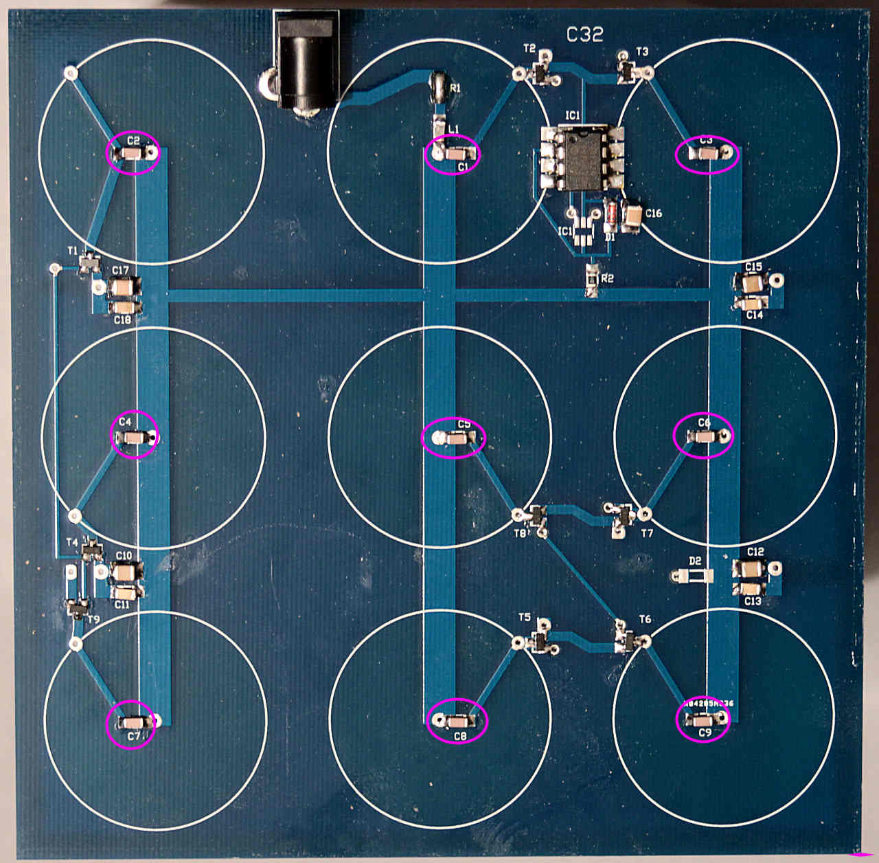

Next the 1n tuning capacitors, one for each coil:

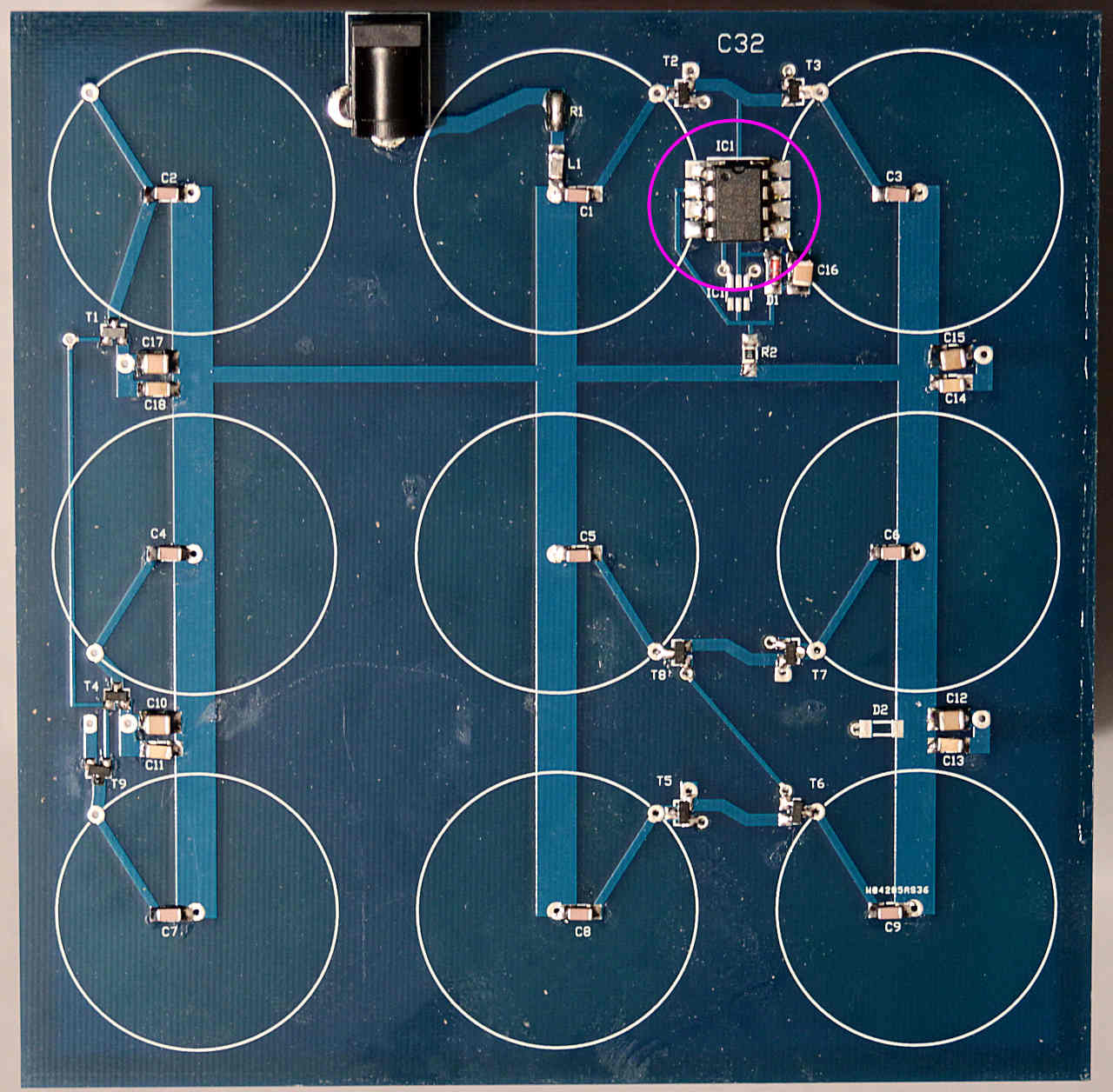

Now solder the PIC controller IC on. You'll need to bend the pins under the IC in a 'squashed bug' shape, then use it as a surface mounted device. You really don't want to have to use the real SMD version of this processor.

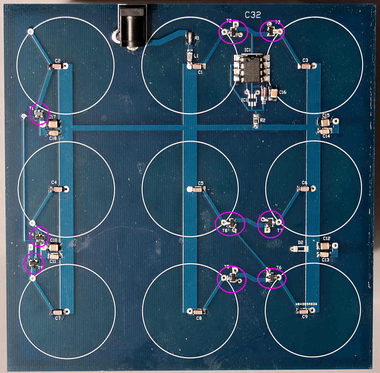

The driver transistors are next, these must be fitted with the engraved text side facing up:
I'd recommend fitting 2-3 at a time, then making another power-up test. You should see the reading increase by about 70-80mA for each transistor. Remeber to disconnect the power supply from the PCB before soldering each batch.
