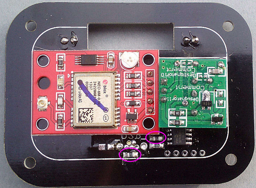

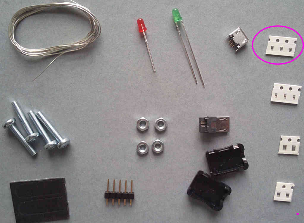

After preparing a suitable working space take the PCB and the 12R resistor (one of the pack of 2 black SMD components, marked 120). Fit this in the location shown:
Re: PCB assembly
Next the RFI filters (two of the pack of 2 grey SMD components). Fit these in the locations shown:
Re: PCB assembly

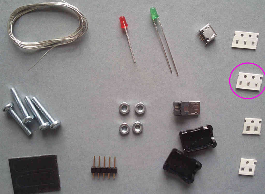

Now for the 1k2 resistors (two of the pack of 3 black SMD components, marked 122). Fit these in the locations shown:
Re: PCB assembly

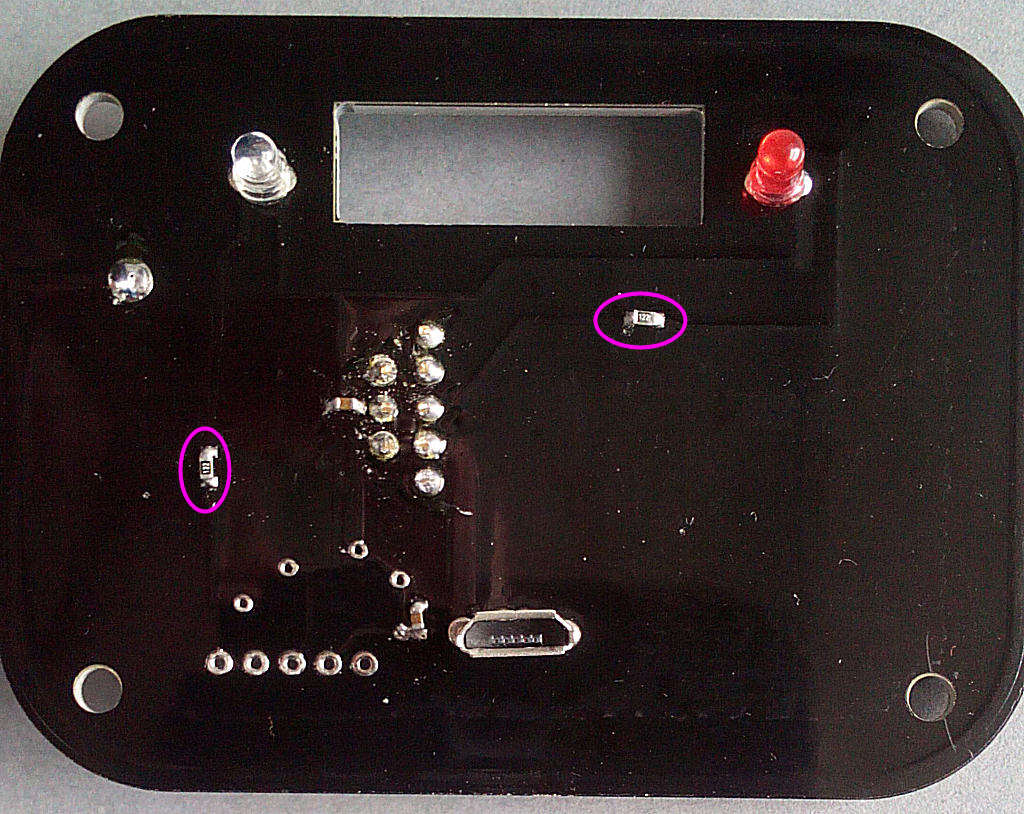

The 0.22u capacitors (two of the pack of 3 brown SMD components). Fit these in the locations shown:

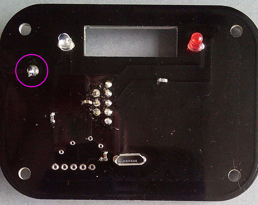

Now for the LEDs - starting with the clear/green. Fit this in the location shown - it's polarised and the SHORT LEG faces to the RIGHT:
Re: PCB assembly
Then the red. Fit this in the location shown - it's polarised and the SHORT LEG faces to the RIGHT:
Re: PCB assembly

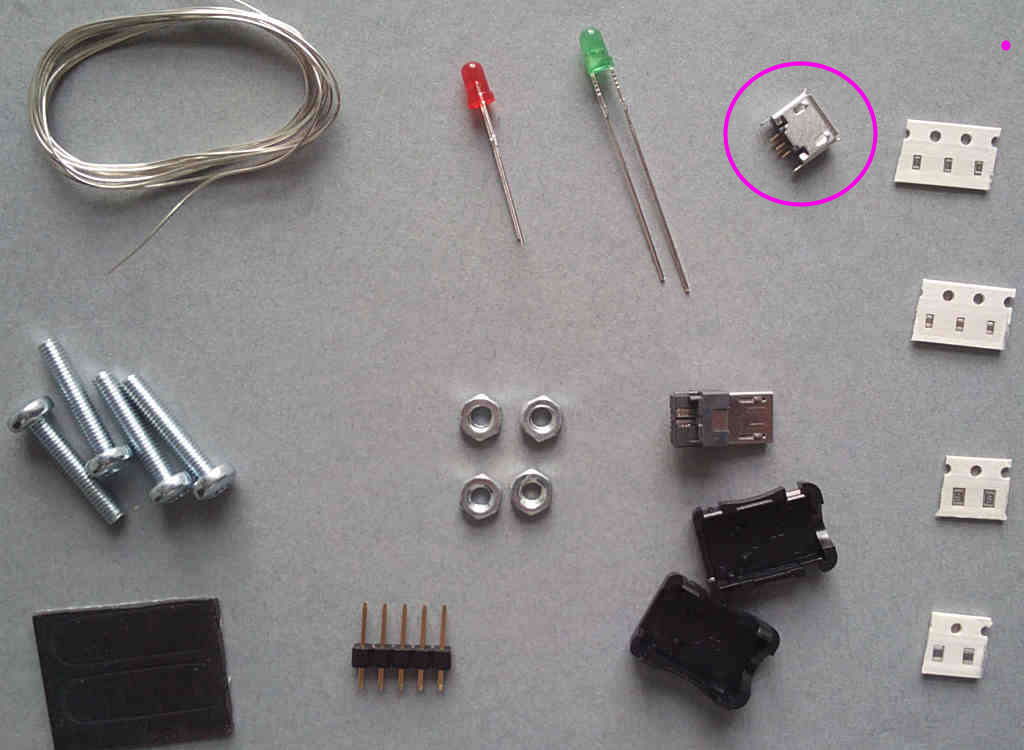

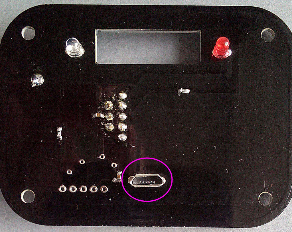

Solder the USB socket next - it's on the same side of the PCB as the LEDs. Make sure you solder the frame leads as well:

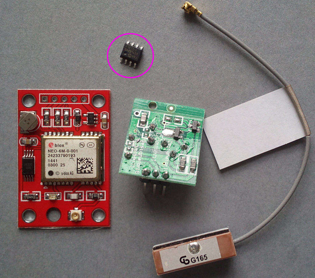

Now the PIC IC - again it's polarised and there's a small dot to indicate pin1. This is the TOP LEFT pin:

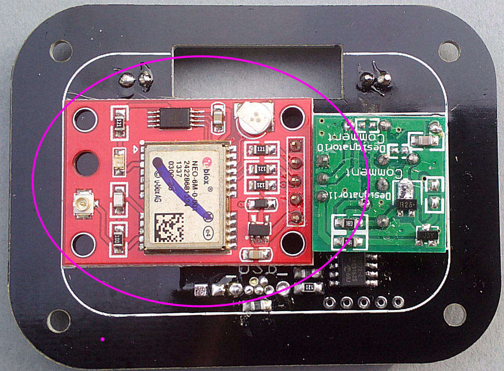

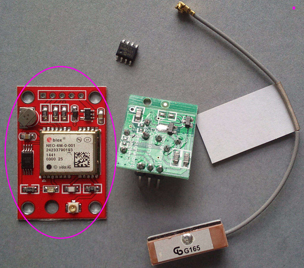

Solder the 5-pin pinstrip onto the GPS module:
Then solder it onto the main PCB - make sure it's on the correct side of the board:
Re: PCB assembly

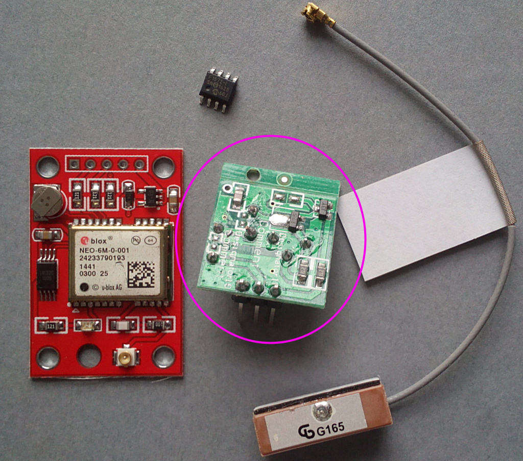

Solder the 433 Tx module onto the PCB next to the GPS module - you'll need to bend the pins slightly to make it fit:
Note that some of the modules may have an extra strip of PCB material attached - you can see it in the photo along the top of the module. This can be snapped off along the score line and will need to be removed for it to fit in the case.
Solder a piece of wire from the pad on the top right corner of the Tx module to the PCB - there's a hole almost directly below it:
