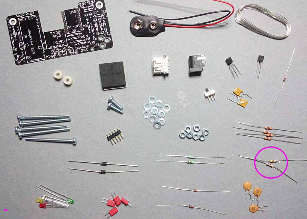

Then the 2x 680R resistors (Blue grey brown). Fit these in the locations marked for R2 and R7:

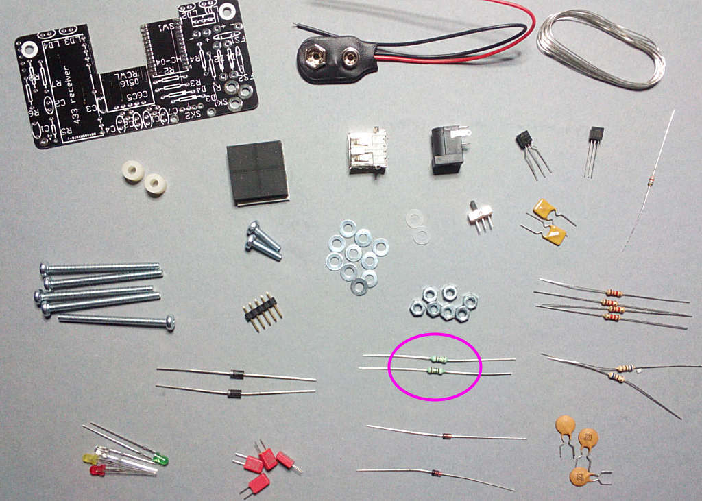

Next the 2x 91R resistors (White brown black). Fit these in the locations marked for R1 and R5:

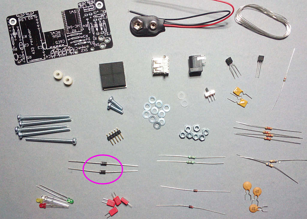

Next the diodes - note all these are polarised so make sure the band on the diode faces the same way as in the photos. Starting with the black plastic ones, fit these in the locations marked for D1 and D2:

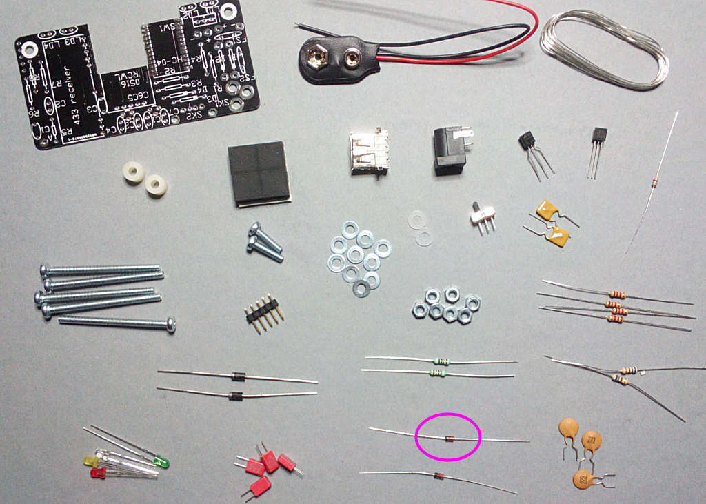

Now the 2 glass diodes, note these are different so check the markings on the diode to make sure you have the right part in each place.

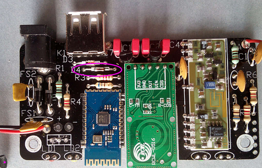

Find the diode marked 3v6. Fit this in the location marked for D4
Re: PCB assembly

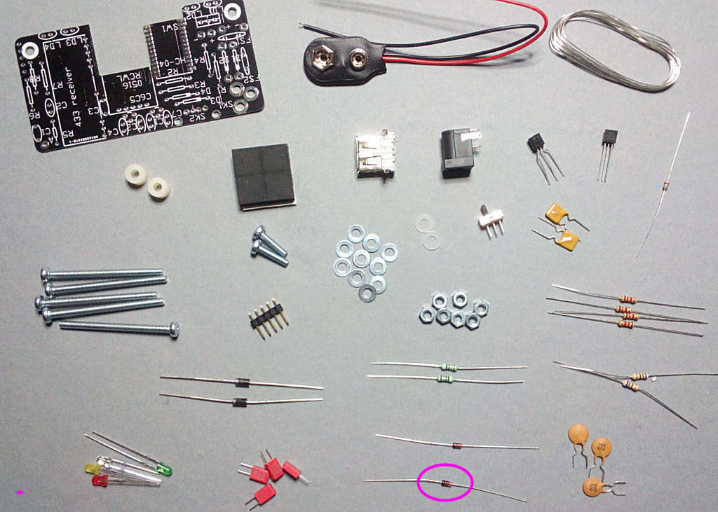

Find the diode marked 6v8. Fit this in the location marked for D3
Re: PCB assembly

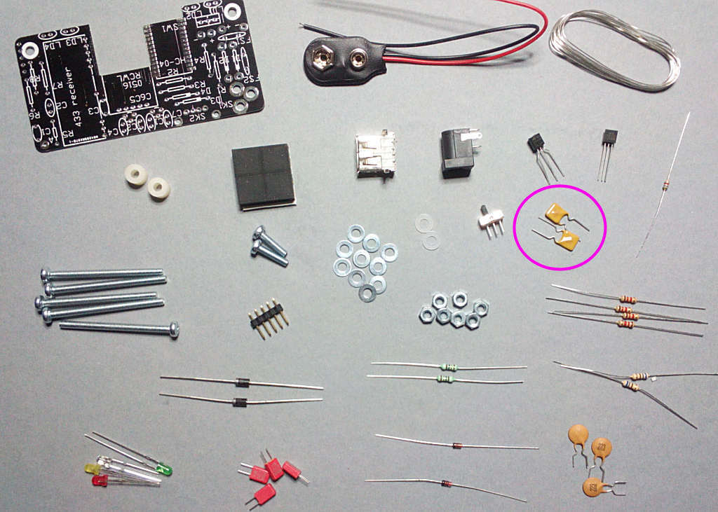

Polyfuses - they look like square ceramic capacitors but protect the device if there's a short. Fit these in FS1,2:
Re: PCB assembly

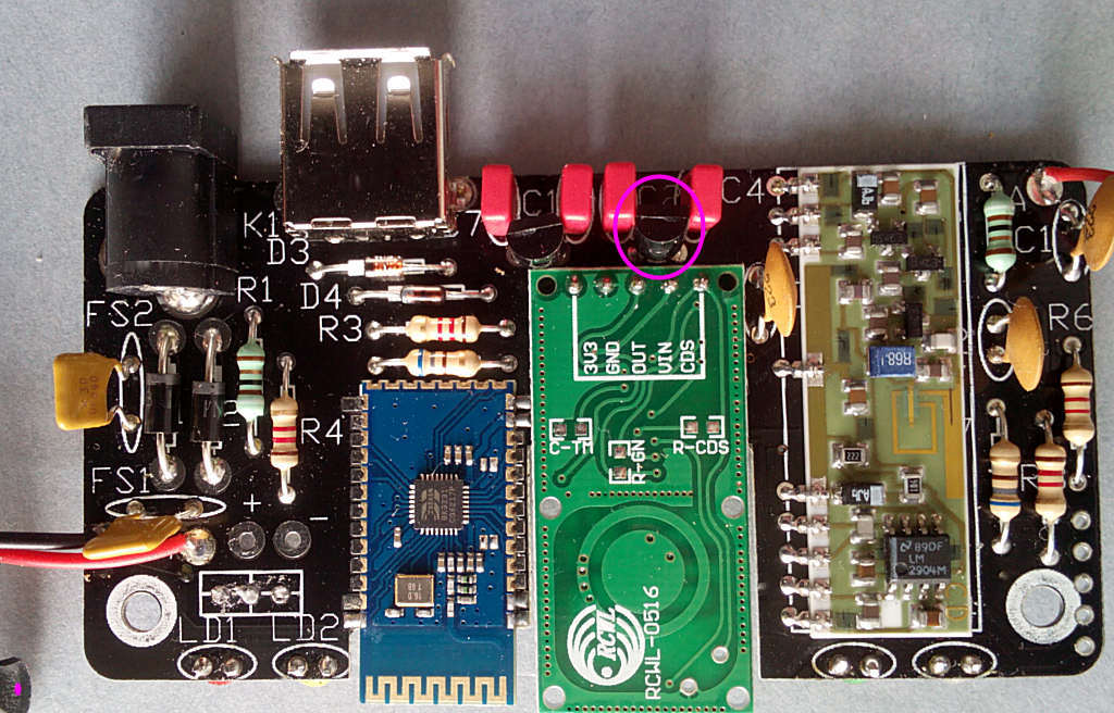

Almost finished with this side of the board for now, just the voltage regulators. Find the one marked '78l05', this is IC2. Note the flat edge faces UP:
