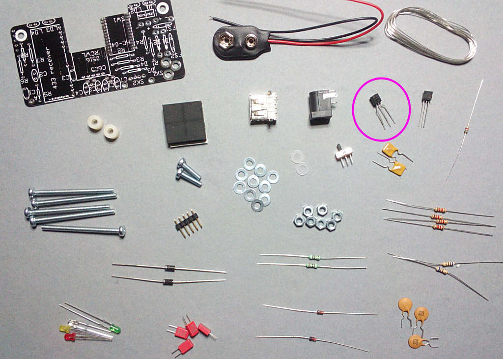

Find the one marked '78l33', this is IC1. Note the flat edge faces UP:

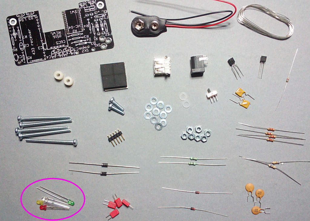

Now a few parts to fit on the other side. The LEDs don't have to be in this order but it will make the instructions easier to follow ;). The SHORT leg faces RIGHT for all four:

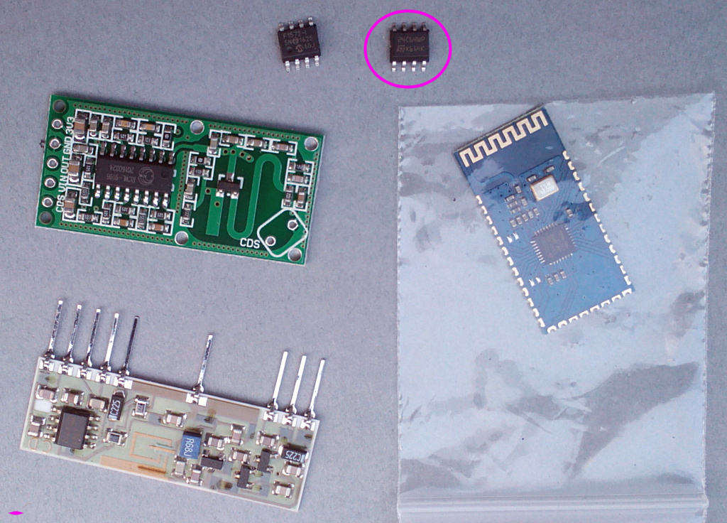

The SMD parts next, IC3: Note the dot faces to the top right.
Re: PCB assembly
IC4: Note the chamfered edge faces up.
Re: PCB assembly

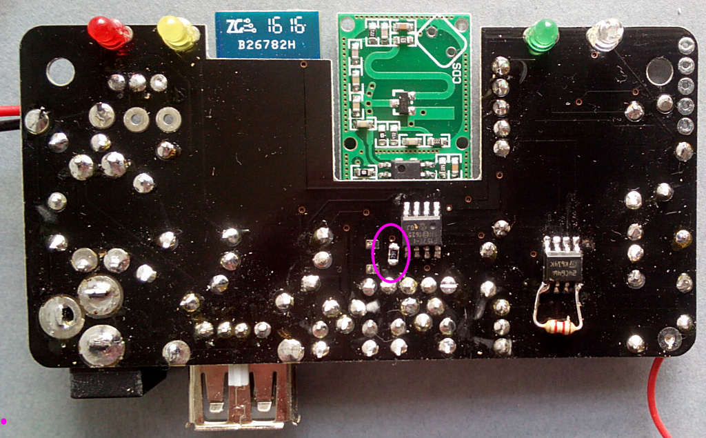

Rx, a 750R resistor in bag1 but not pictured.
and finally Ry, a bodged-on 5k6 connected across IC4 (1k2 in the picture but it's a 5k6 now):

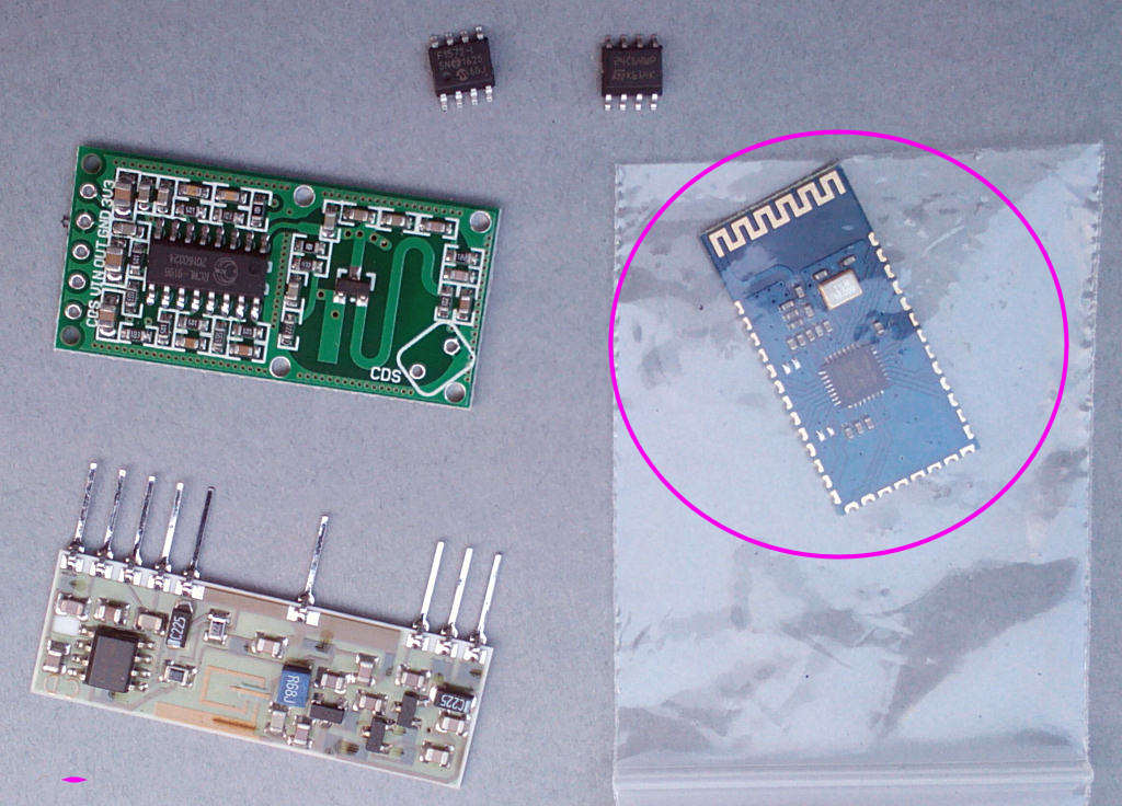

Finally the modules. Start with the Bluetooth module as it's the most difficult to solder into place. Note only the pads indicated need to be soldered:
