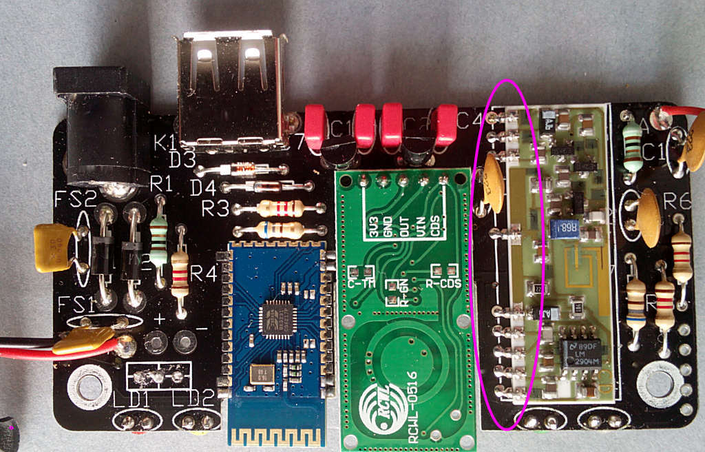

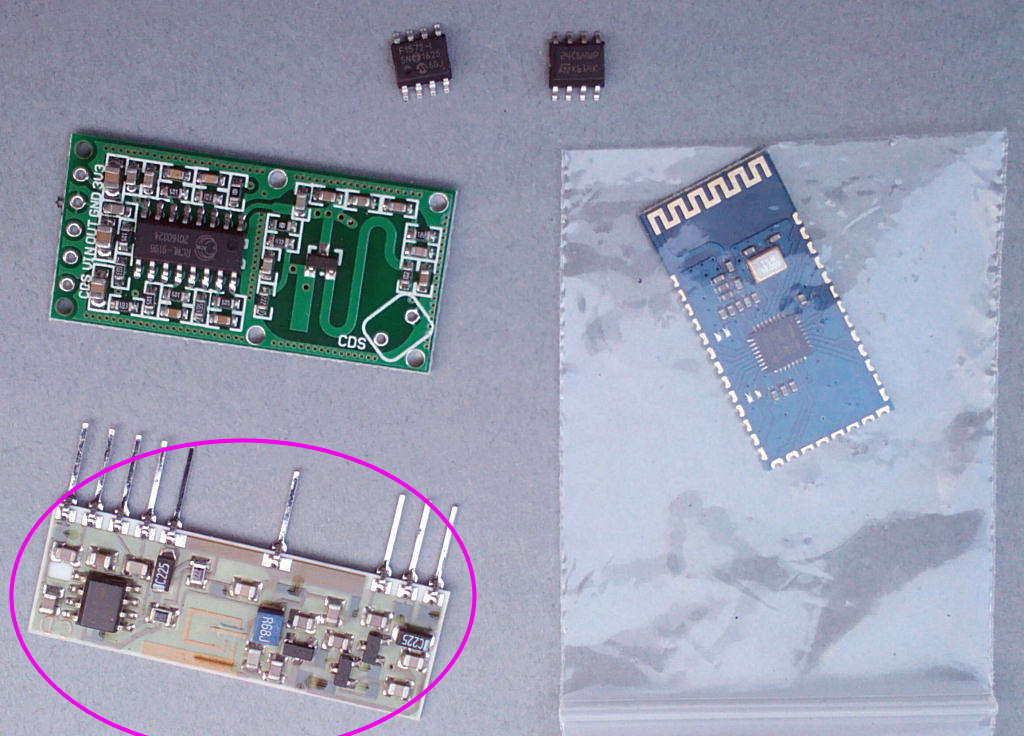

Re: PCB assembly
Next is the 433 Rx module. Carefully bend the pins before soldering it in, it's ceramic not fibreglass so it will break if not handled carefully:

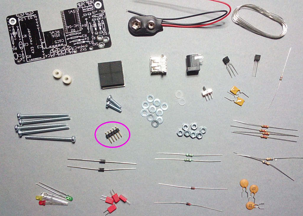

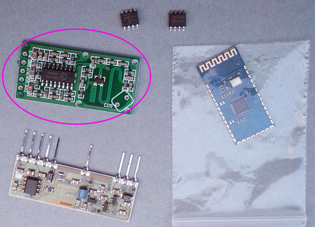

Re: PCB assembly
Finally the movement detector. Solder the 5-pin strip onto the module first - the pins face the same way as the components on the module PCB:
Then solder the module onto the main PCB:

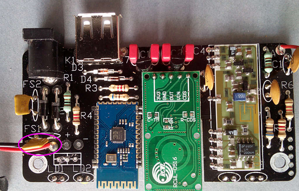

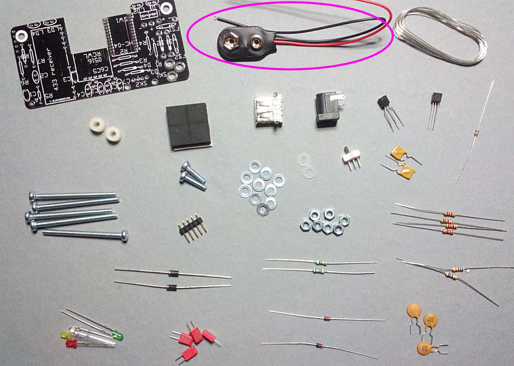

Re: PCB assembly
Last bit of soldering - the PP3 connector. Solder the 2 wires as shown (under FS1 red to +, black to -):
