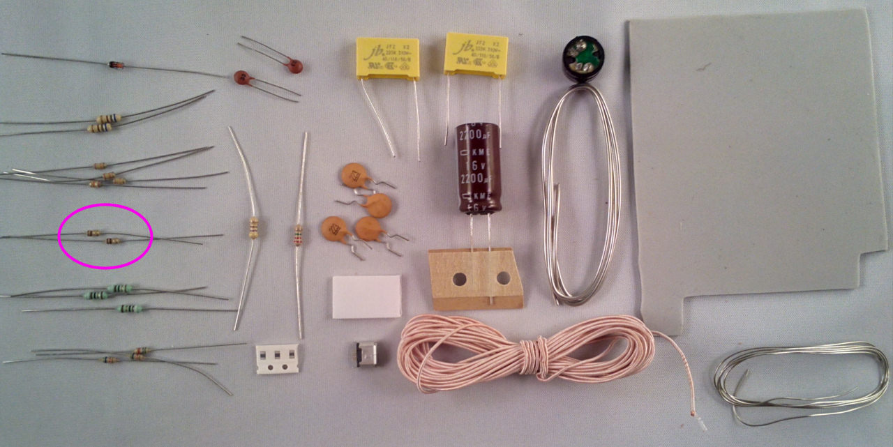

The PCB assembly is described in 2 stages, the first covers the majority of the components before first test and the second stage after it's attached to the levitation assembly, at which point you'll need to be much more careful of flying screwdrivers...
The exact order of assembly will depend on the preference of the builder but convention is to fit the resistors/diodes first followed by capacitors, transistors and finally the ICs, USB socket/power conectors in that order. Use the thin solder for the small components and the thick solder for joining the PCB to the levitation module.
Starting with the resistors, take the 2x 680R (blue grey brown) resistors and fit them into the locations marked R16 and R17:

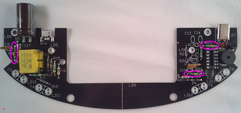

Take 4x 24k (red yellow orange) resistors and fit them into the locations marked R9,18, 19 and R23:

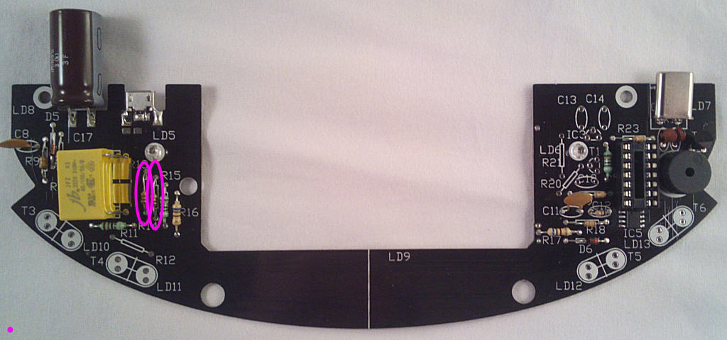

Now the 2x 1r1 (brown black gold gold) resistors, fit them into the locations marked R13 and R14:

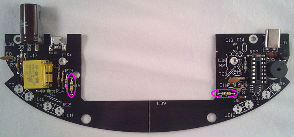

And the 3x 91R (White brown black black) resistors, fit them into the locations marked R11,15 and R22:

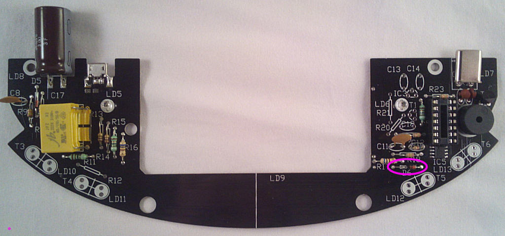

Now the zener diode D6, make sure it's fitted with the black band facing left:
