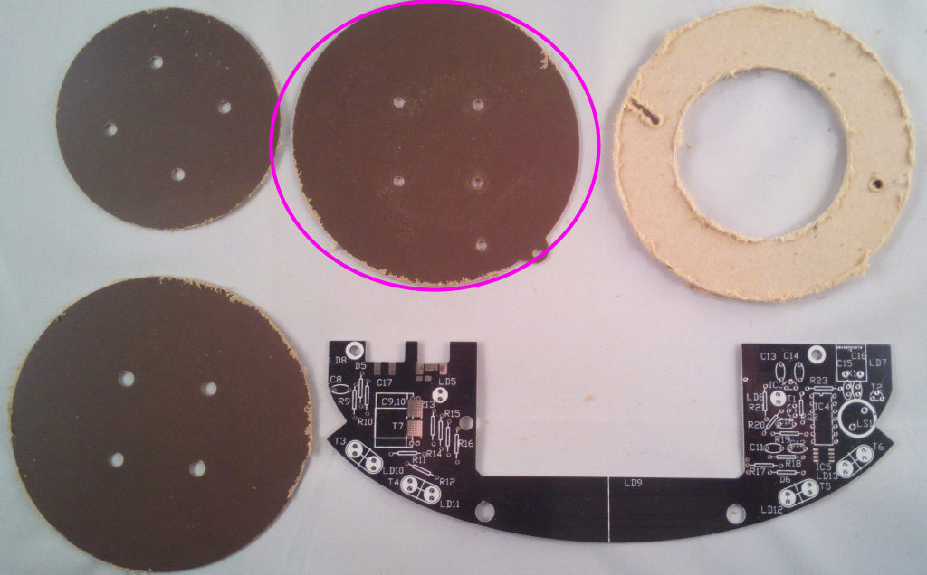

To wind the base coil you'll need the circular coil former pieces from bag4 and the bundle of wire from bag1.
You'll need to sand the former pieces first but as they're not seen don't worry about scratching them.

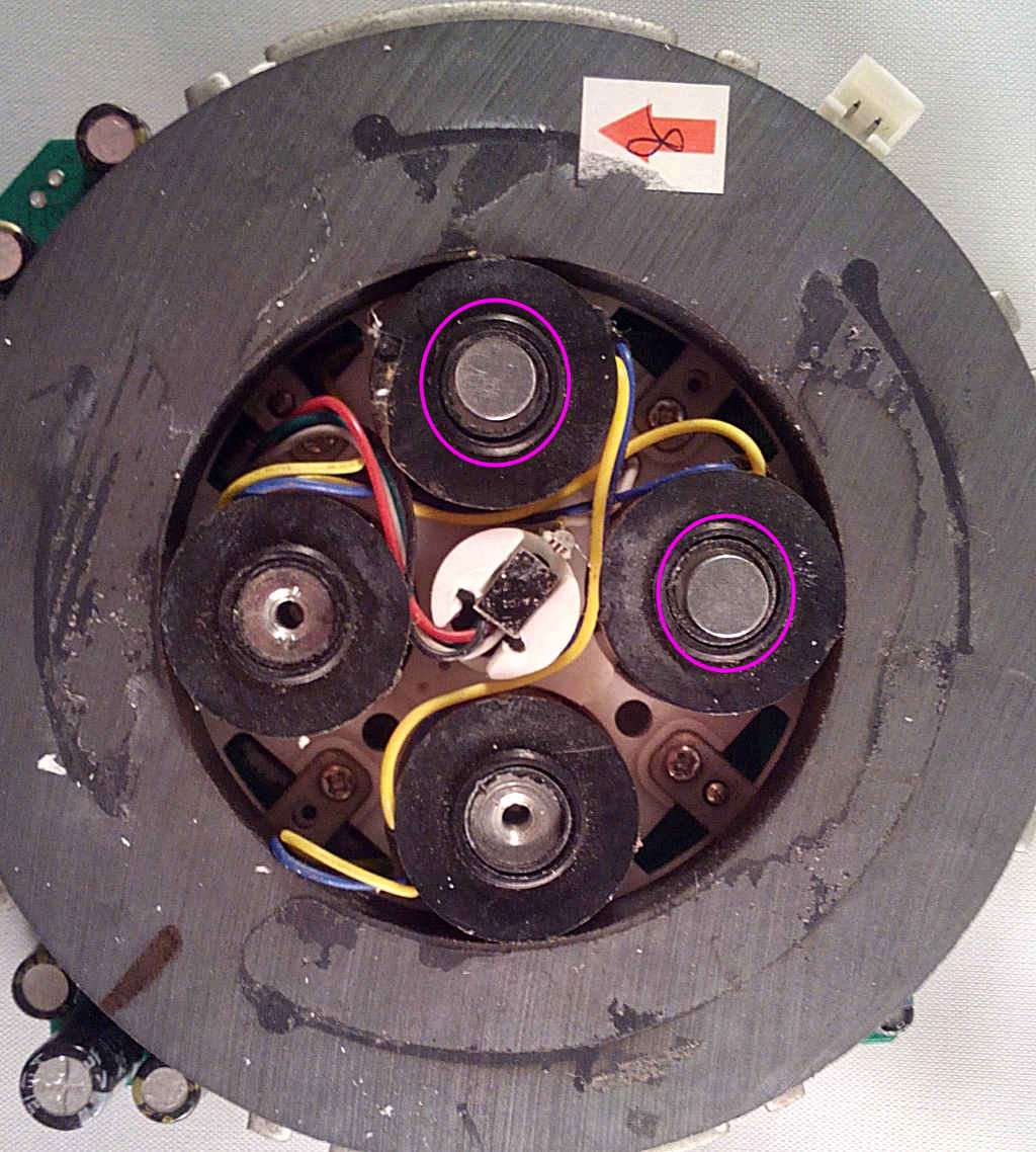

Start by removing the small magnets from the electrmagnets, if fitted:
Leaving the threaded holes clear to fit the coil:
NOTE I have been helpfully sent one box of bases which didn't have these drilled but look the same until the magnets are removed. If you've been sent one of these please contact me, don't attempt to disassemble the base further.

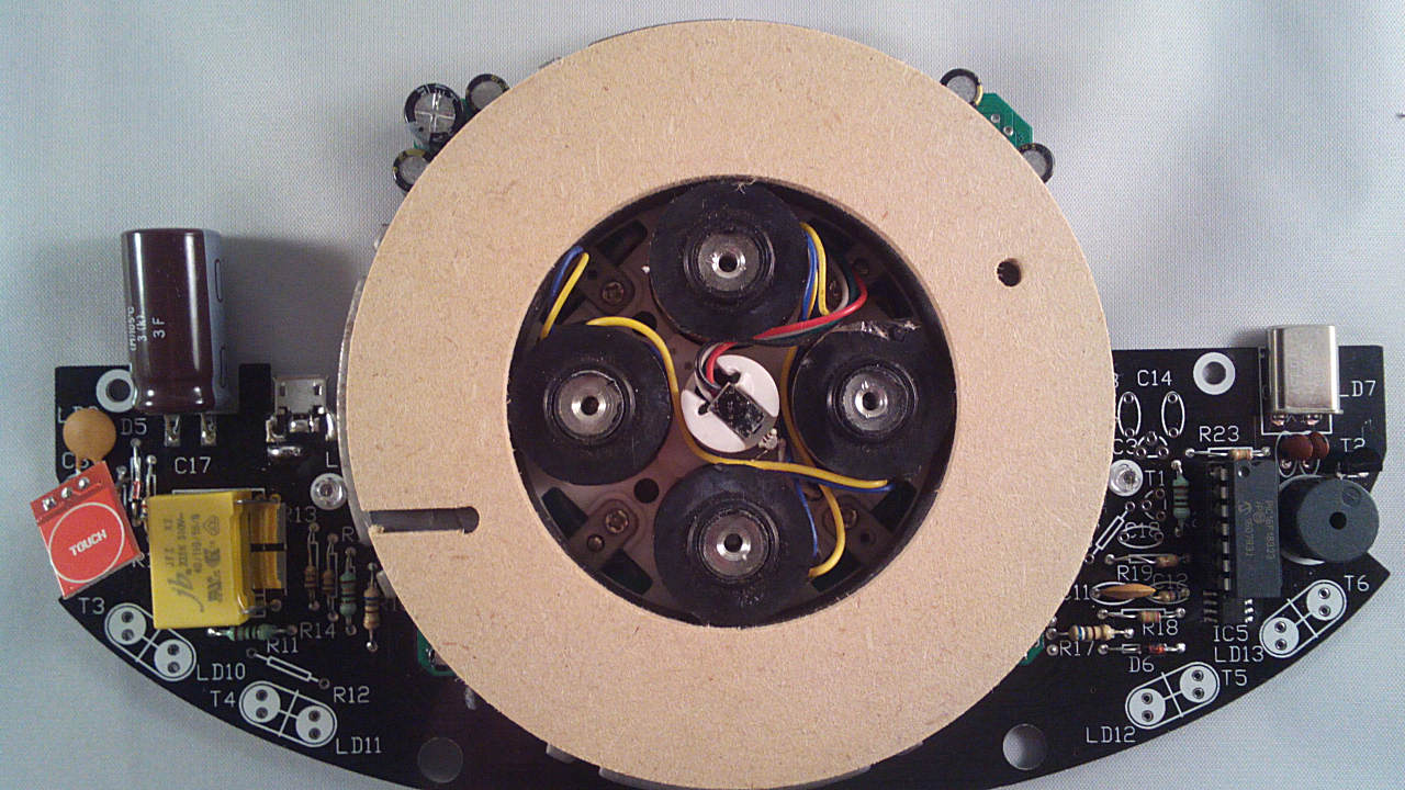

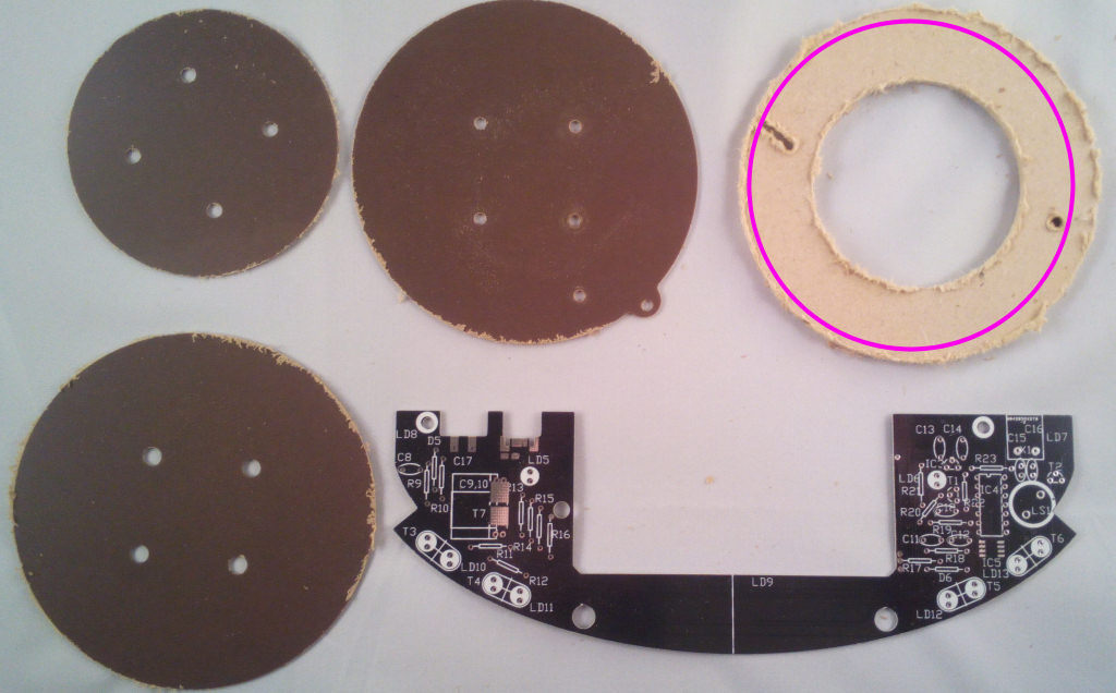

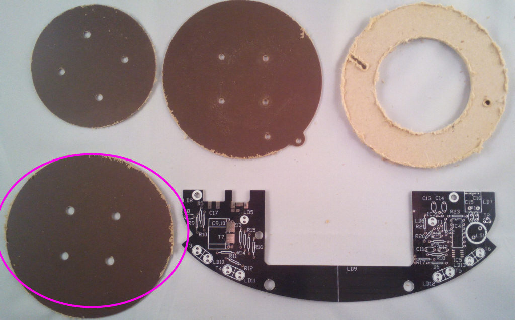

Starting with the MDF spacer, asseble the coil former stack. Make sure the slot is facing as shown in the picture:
Re: 3 - Coil Assembly

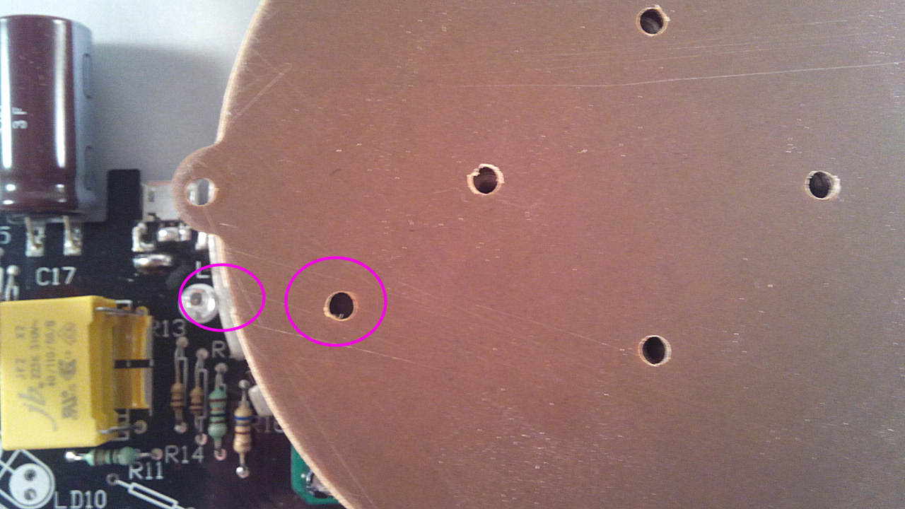

Next is the bottom laminate disc, make sure the hole lines up with the slot in the MDF spacer:

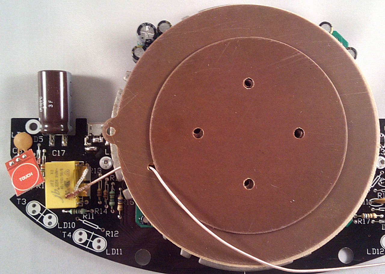

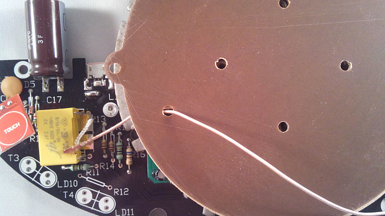

Feed the wire through that hole and the slot, leaving just enough to reach the yellow capacitor pads:

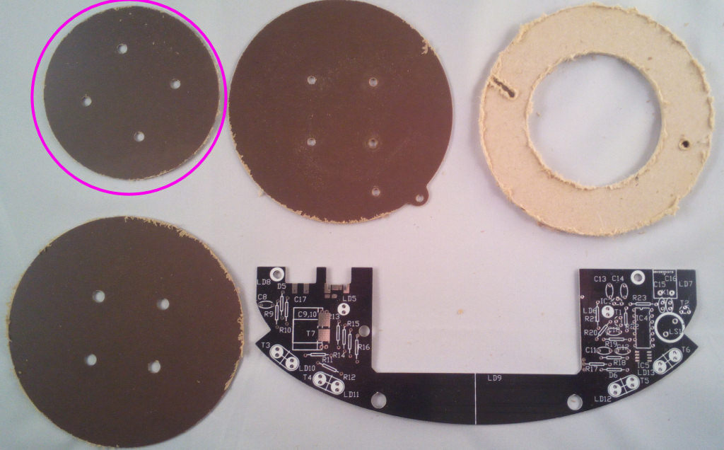

Then the laminate top disc:

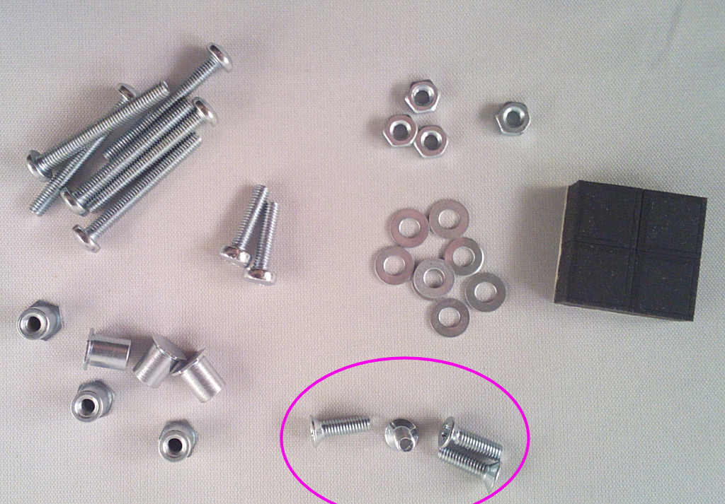

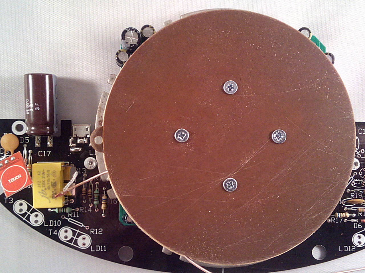

Bolt them down using the 4x M12 countersunk bolts in Bag3 - make sure all the pieces are centred:

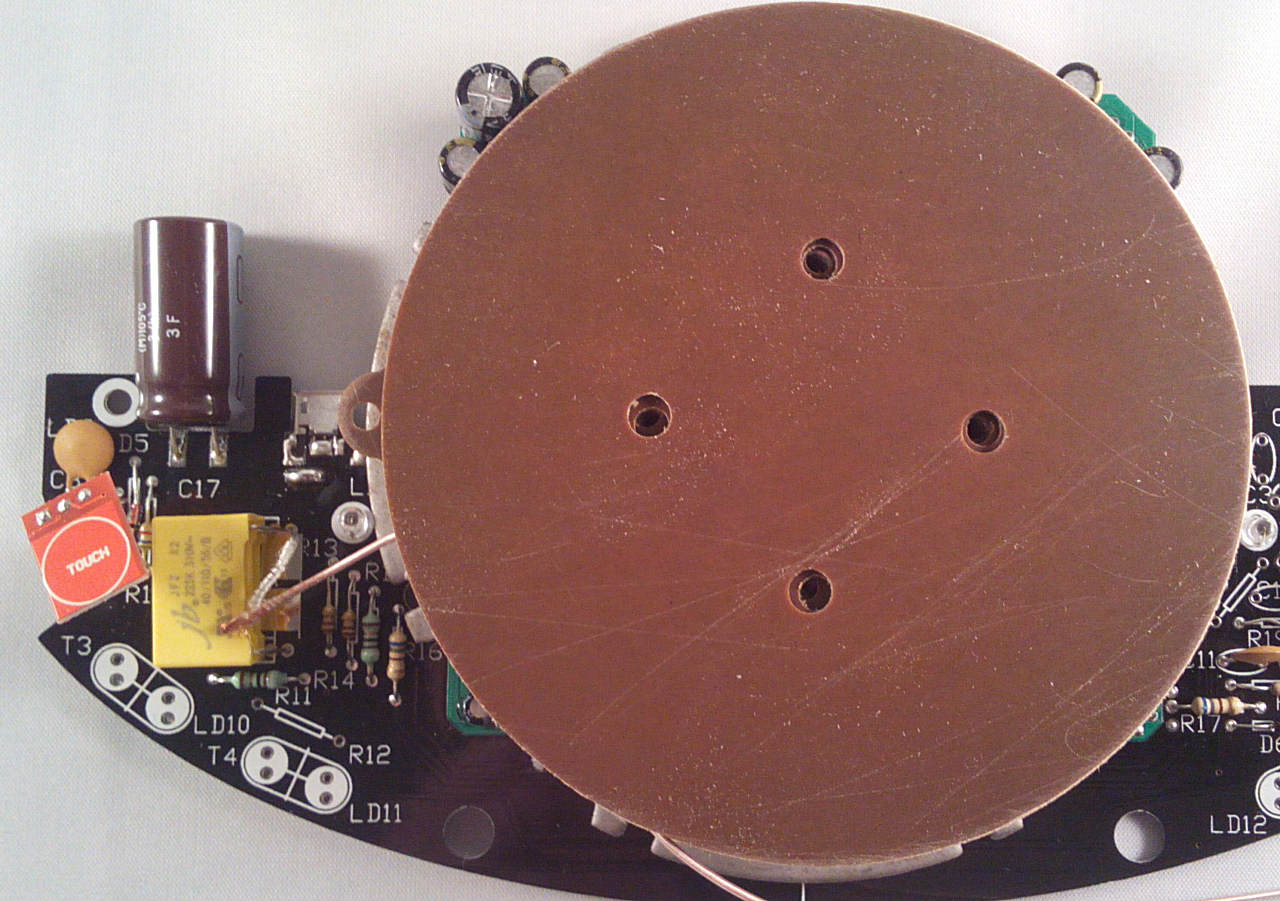

Now carefully wind 13 turns of wire onto the former. There's not much space so they'll need to be fairly tight and the last turn will be just over the edge of the discs.
Cut the wire leaving just enough to reach the capacitor pads and feed it through the hole in the bottom laminate disc tab.

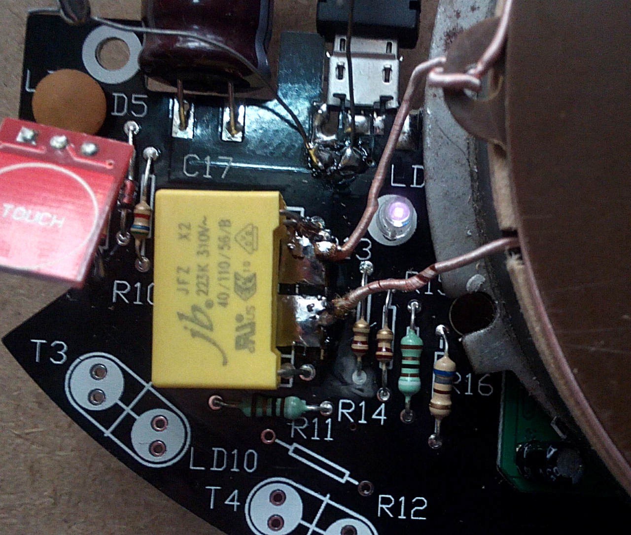

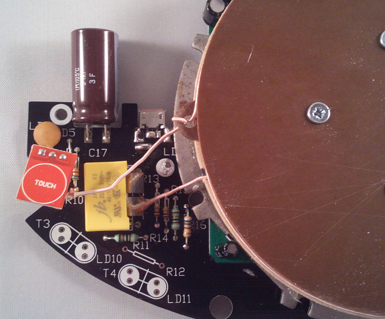

Tin the wire ends and solder them to the 2 square pads between the yellow capacitor leads:

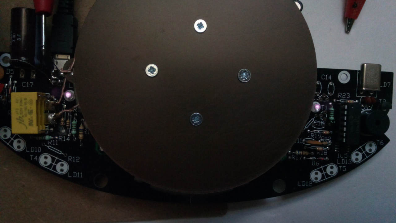

Reconnect the multimeter and connect the USB power cable. Switch on and check the current drawn now - it should be 220-240mA. Make a loop of solder and move it close to the base coil - the current should increase considerably.
Using a camera phone, view the infra red LEDs and check they flash once a second:
If everything is working as expected, unplug and remove the meter leads. Unsolder the test point wires and bridge the 2 pads with solder. You should now have a working base unit to allow you to build and test the floating clock section - I'd recommend doing that before assembling the case just to confirm everything is working.

[quote="Tony"]Bolt them down using the 4x M12 countersunk bolts in Bag3 - make sure all the pieces are centred:
That'll be bag 4 ... or it was in my kit
