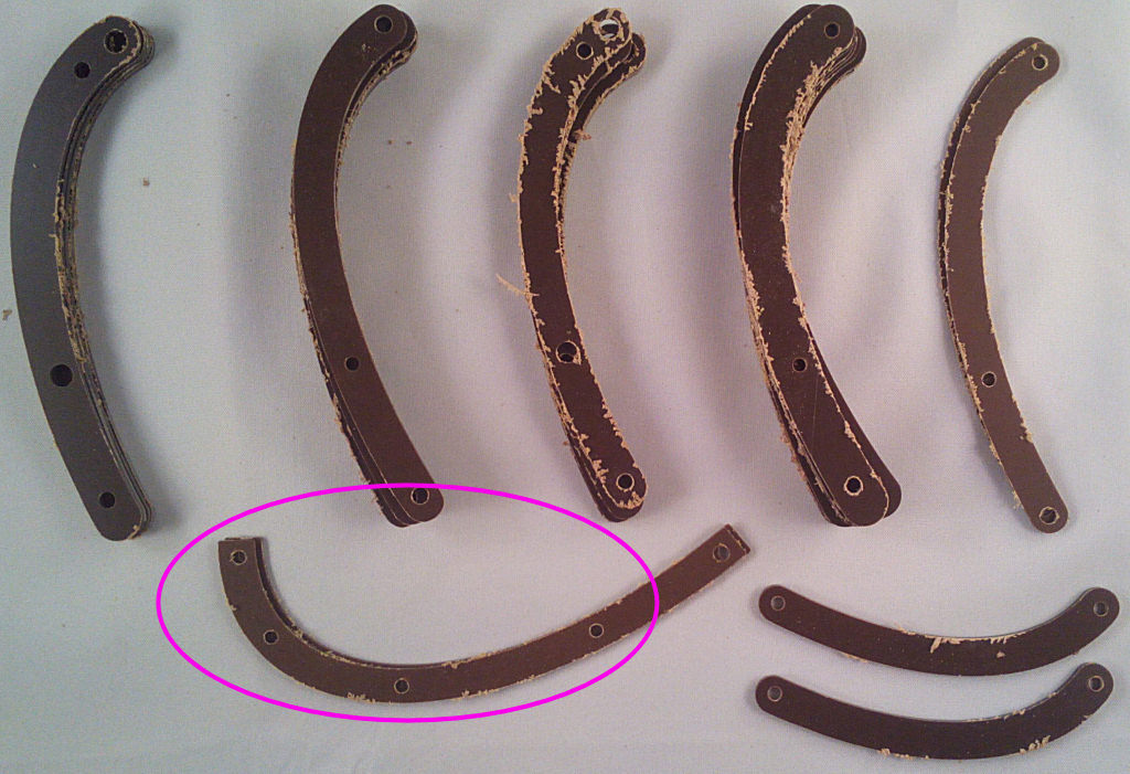

Before starting, make sure the touch switch is just below the level of the lid (the top of the coil former disc) - it doesn't need to be flat, just point the tip of it up and it should work. Some of the wide long strips have misplaced holes so you may need to correct them before assembly with a file or dremel.

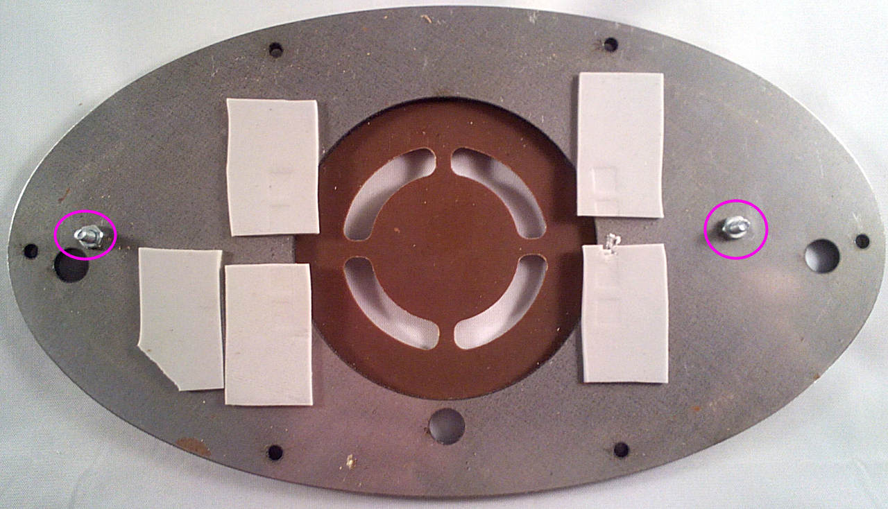

Put the 2 short M3 bolts through the holes marked:
Posts: 949
Re: 4 - Case Assembly

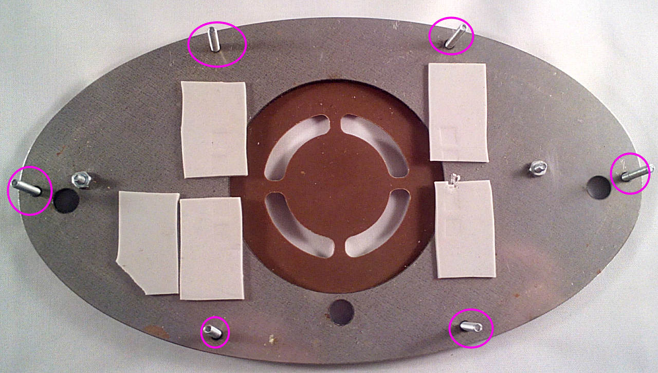

Turn it over and fit nuts onto the bolts to hold them in place:
Put the 6x long M3 bolts through the outer holes - don't use washers as they're only just long enough:

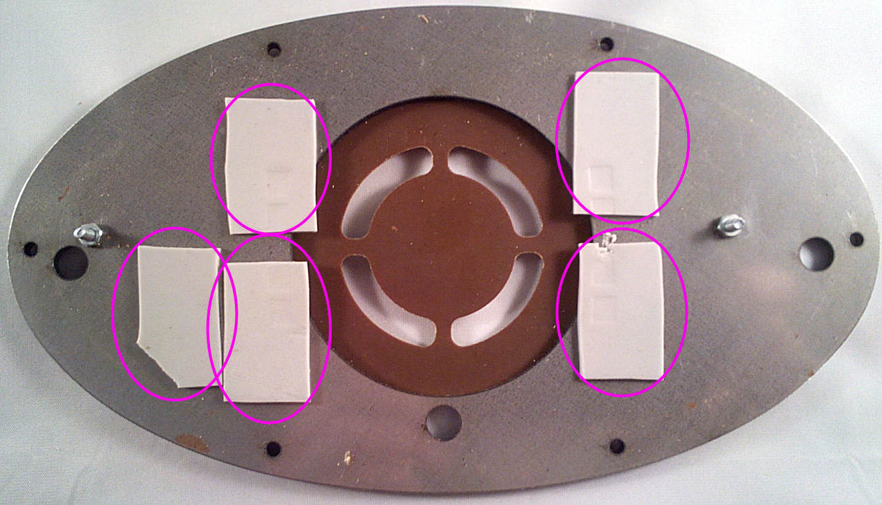

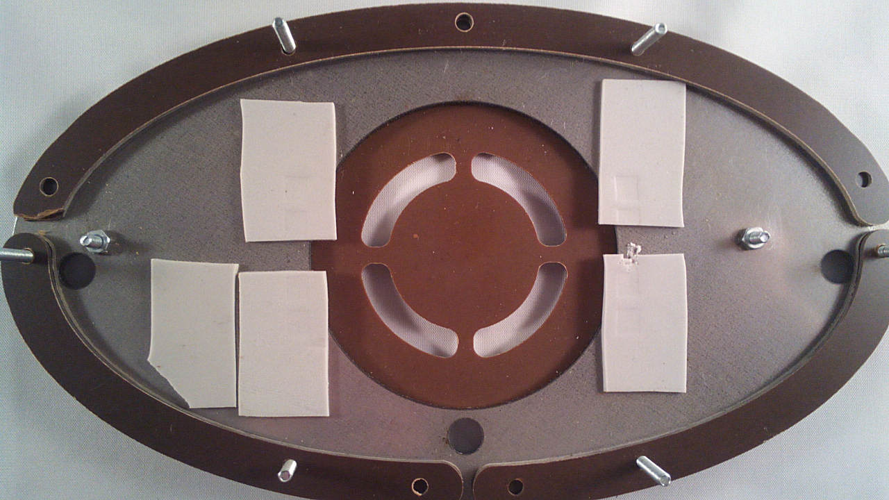

Cut some pieces of silicone heatsink pad (from Bag1) and lay them on the baseplate as shown:

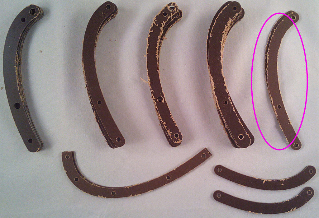

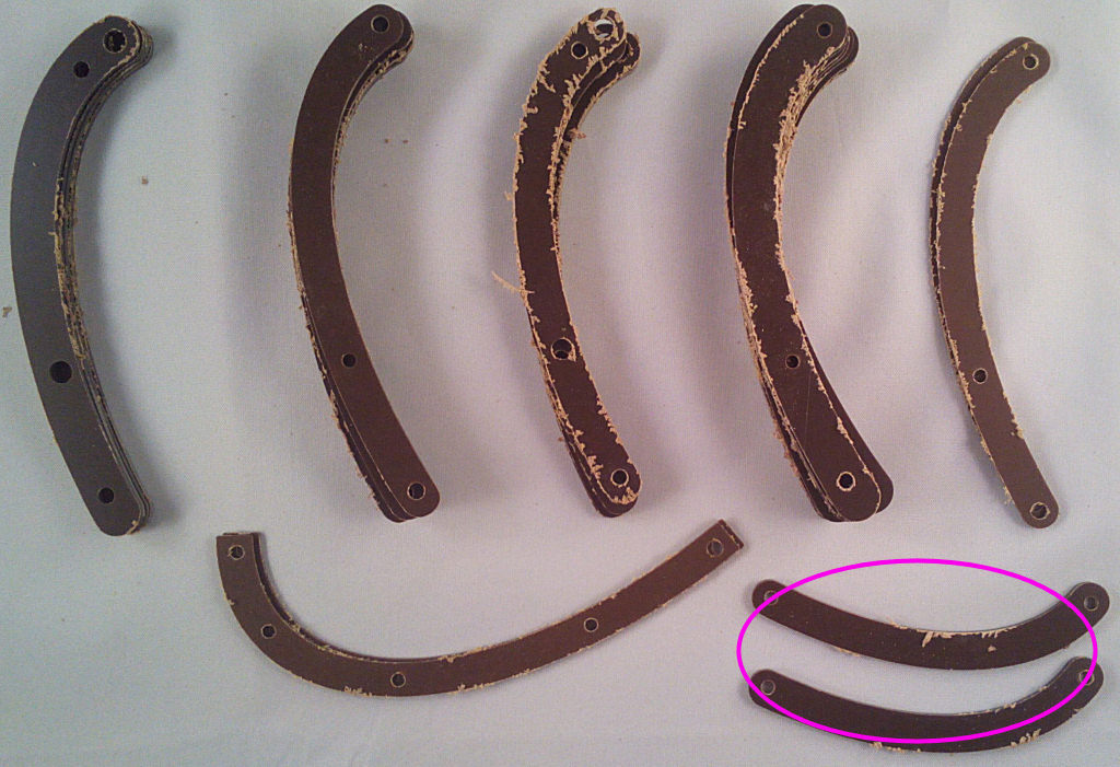

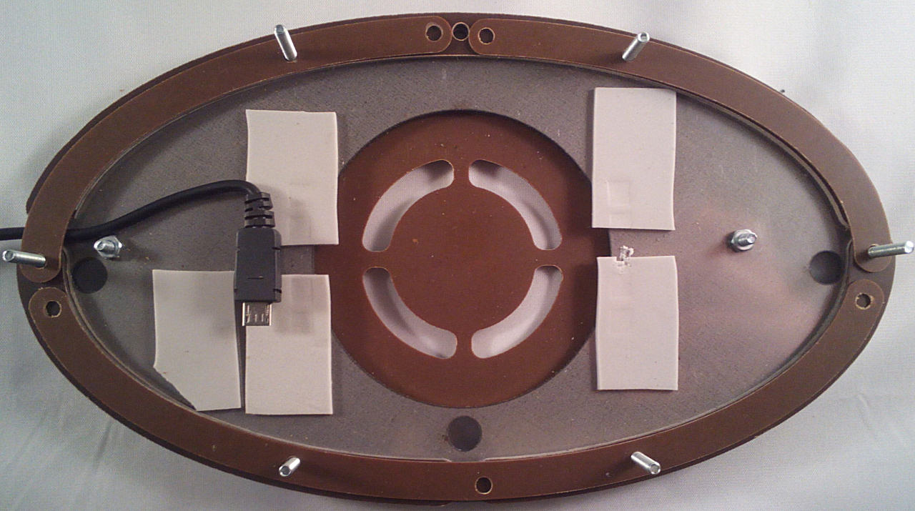

Next you'll need 1x long narrow strip with 3mm holes and 2x short narrow strips with 3mm holes:
Note the end of the strips on the left have been trimmed slightly to allow the USB cable to fit.

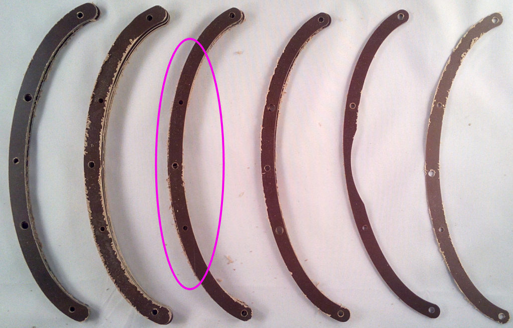

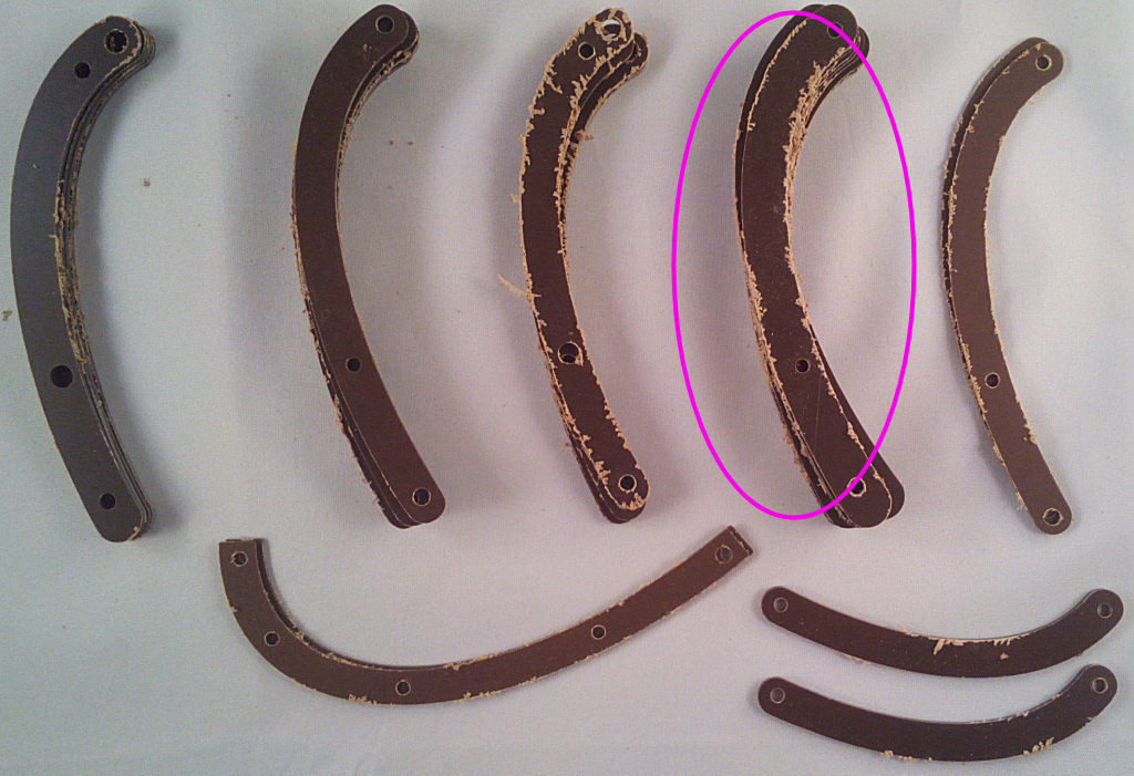

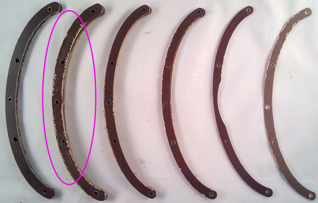

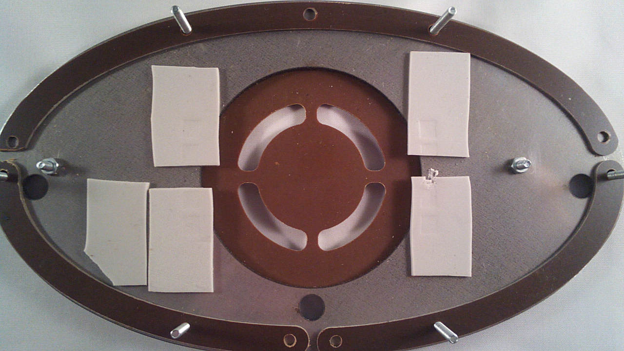

Then a layer of 1x long wide strip with 3mm holes and 2x short wide strips with 3mm holes:
Note the end of the strips on the left have again been trimmed slightly to allow the USB cable to fit.

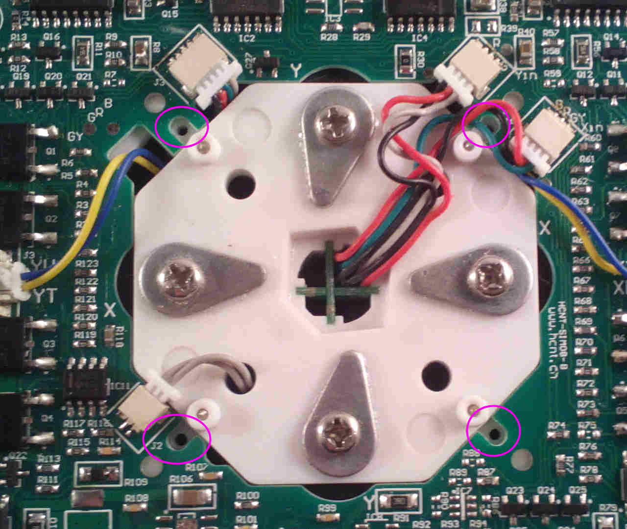

Remove the 4x small screws that hold the levitation PCB to the magnet frame. This will prevent stress on the PCB when it's held by the case strips.

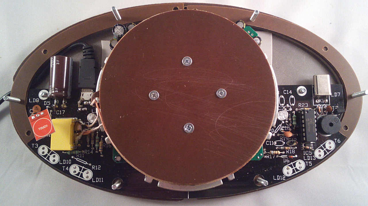

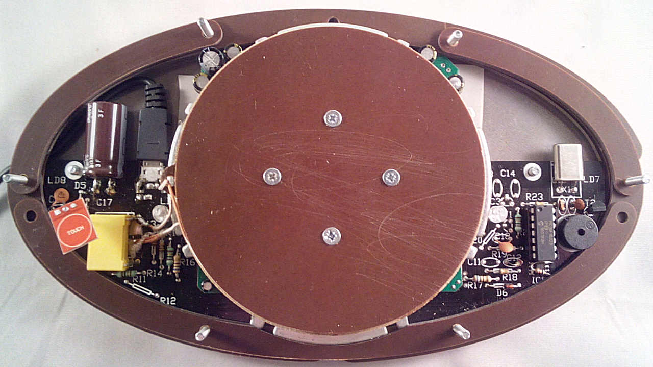

Drop the levitation PCB assembly over the short bolts and onto the strips as shown. Carefully connect the USB lead.
Fit the 2x 0.8mm PCB supports aroud the top of the case:
Using 2x washers and bolts, bolt down the PCB.

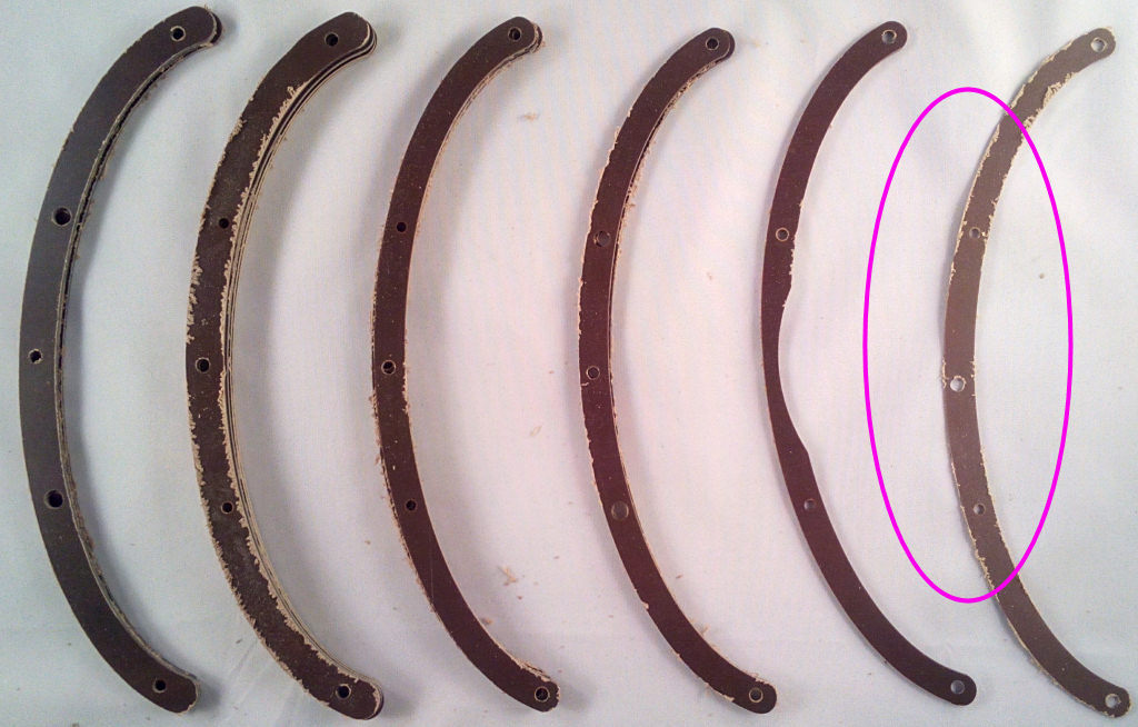

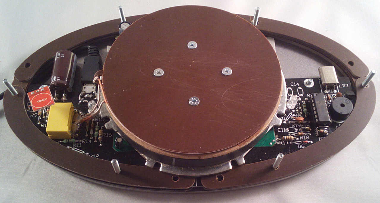

Now build a layer of 1x long wide strip with 3mm holes and 2x short wide strips with 3mm holes:
Note you'll need to carefully lift the magnet assembly to fit the strips under it.
