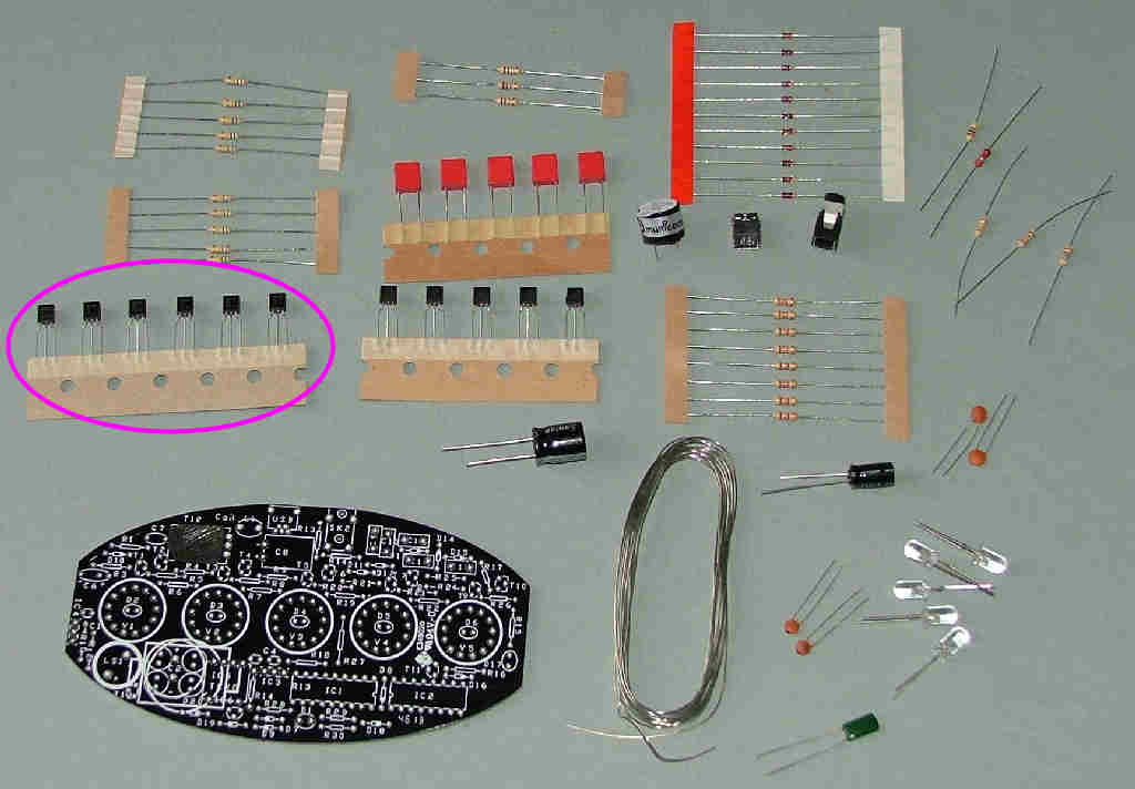

Now assemble the nixie sockets::
Using wirecutters or pliers carefully break the turned pin sockets out of the plastic housing:
Push the pins into the holder:
There should be enough parts to make 6 of these sockets but you'll only need 5. Once made, drop them into the V1-5 positions on the PCB and solder them in place.

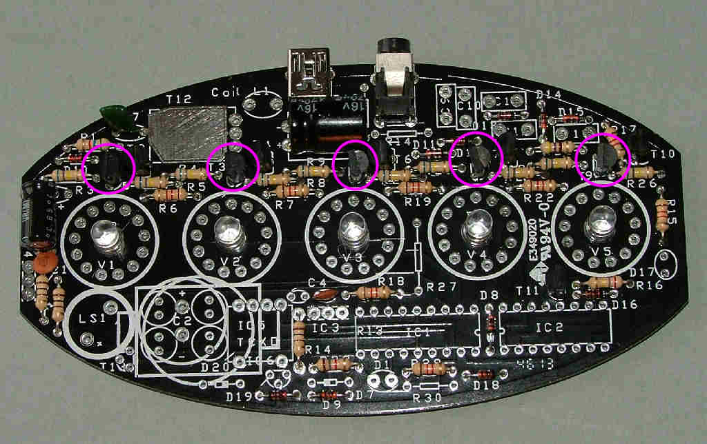

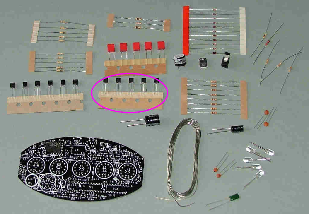

Fit the black plastic transistors x5 marked 'MPSA92' or '2N6520**' in locations marked for T1,3,5,7 and 9 as shown: NOTE these are polarised and must be fitted the right way round. There is a flat mark on one side of the body, this flat side faces to the LEFT of the PCB when viewed as shown in the photograph.

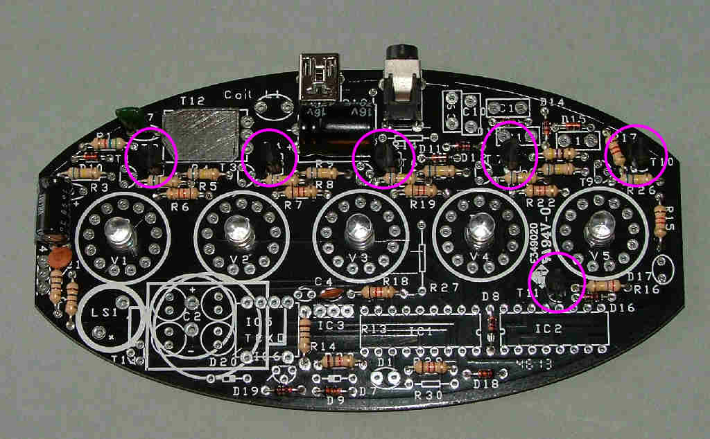

Fit the black plastic transistors marked 'MPSA42' or 'KSP42' in locations marked for T2,4,6,8,10 and 11 as shown: NOTE these are polarised and must be fitted the right way round. There is a flat mark on one side of the body, this flat side faces to the RIGHT of the PCB when viewed as shown in the photograph.

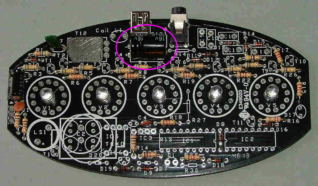

Fit the blue or black aluminium can 470u 10V/16V capacitor in the location marked for C8 as shown: NOTE this is polarised, the negative- terminal is marked with a white band. This faces towards the BACK/TOP of the PCB when viewed as shown. Try and leave enough room on the right of it for R13 to be fitted.

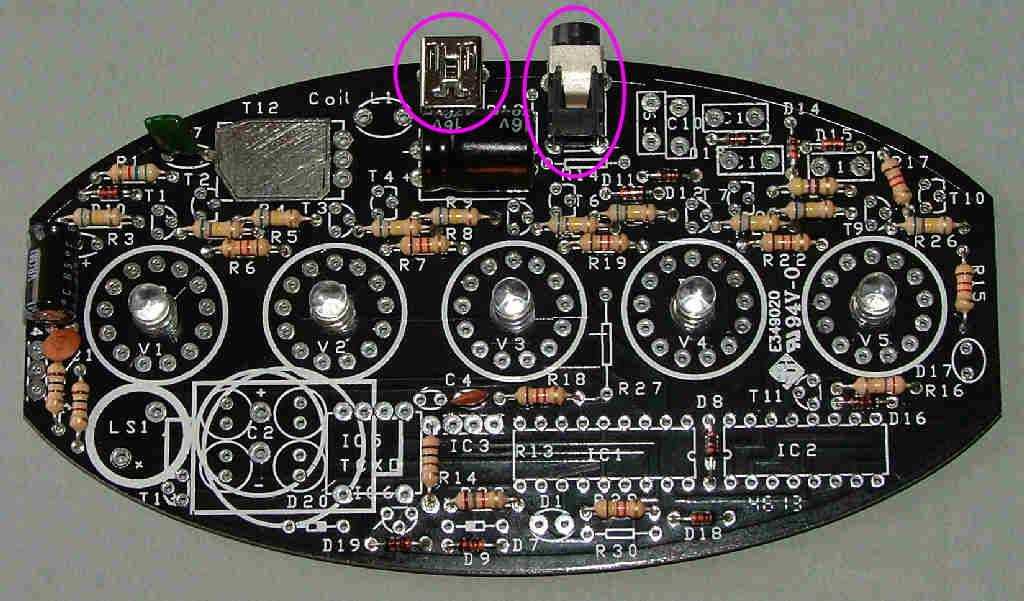

Carefully fit the USB socket, it may be a little tight but don't push too much or you may damage the pins. Fit the 3.5mm jack socket marked SK2:

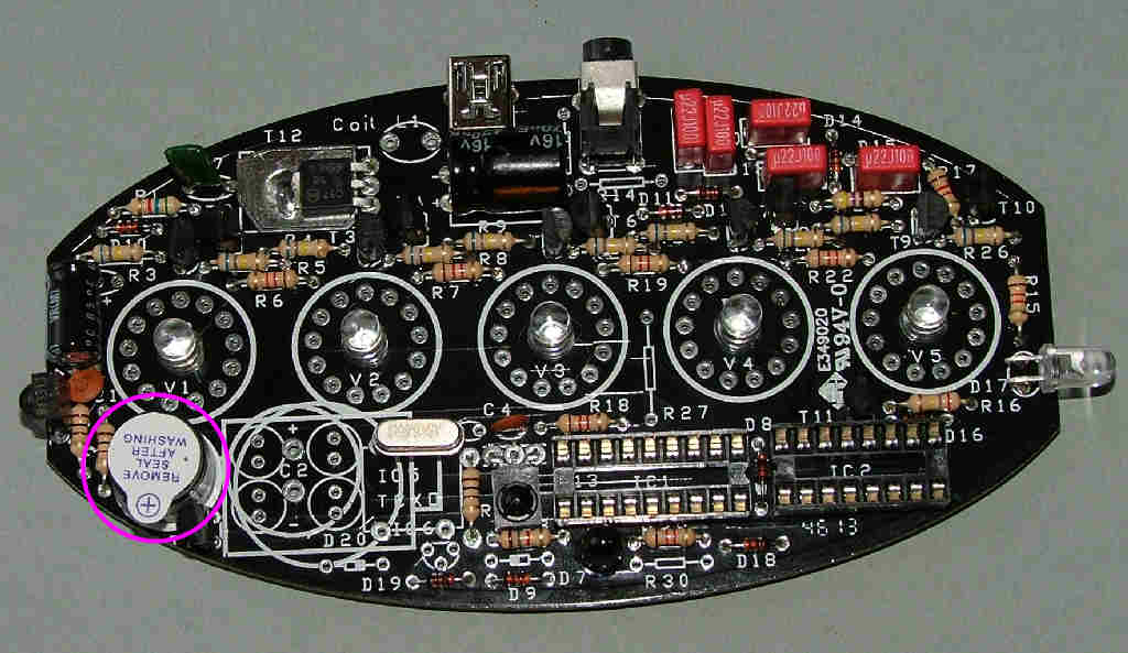

We've almost finished with bag 1 for now - just the buzzer LS1 left to fit.

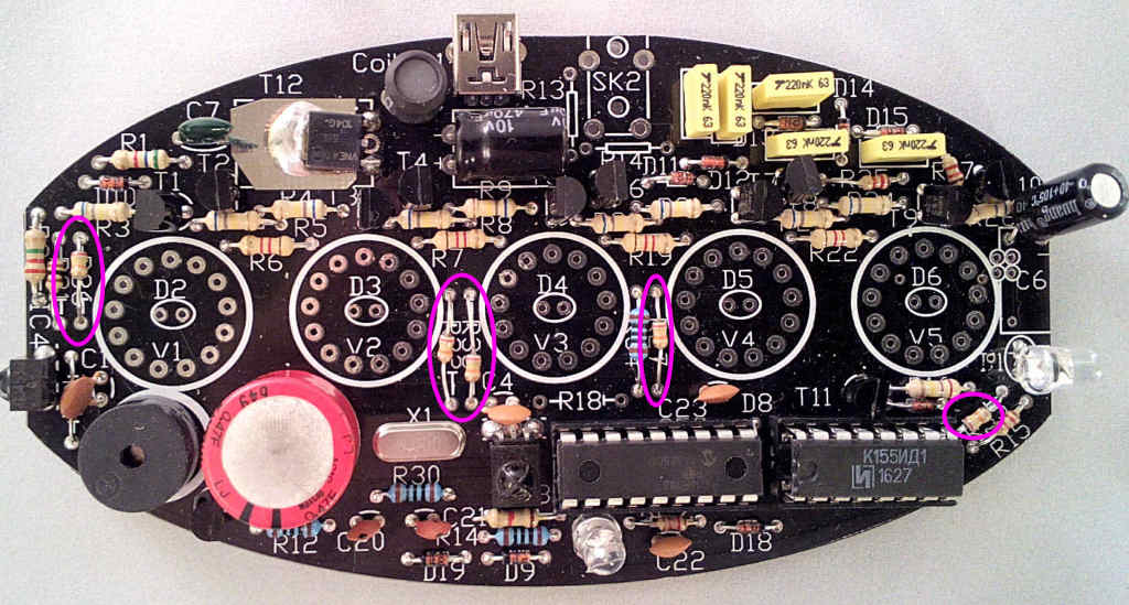

You should have 5x 24k resistors left over (red yellow orange). These are fitted in places marked R27,32,33,35 and 36:
