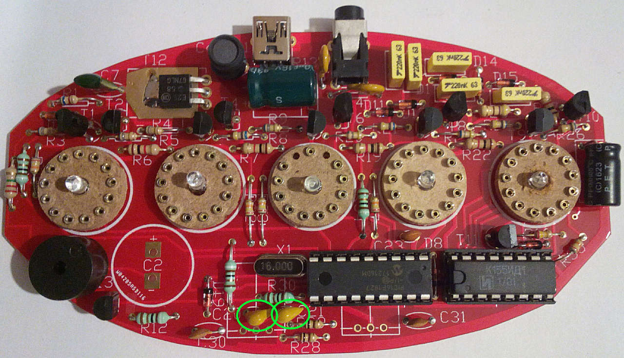

Fit the 2x 22pF yellow ceramic capacitors marked '220' in C20,21:
Time to start on Bag 2, but first take a few minutes to go back through the instructions and double-check you've got eveything in the right place. Correcting mistakes will get harder from here on.
